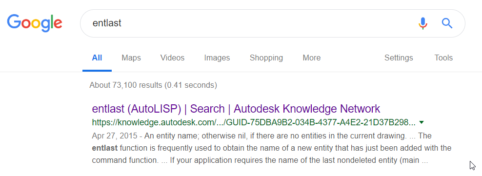

I think "entlast" doesn't do what I thought.  I moved an object and the "entlast" object went to the last created object rather than the object I just moved.
   (setq ttt (vlax-ename->vla-object (entlast)))
So I tried to go to the object directly by a region and that failed.
   (setq ttt (vlax-ename->vla-object (ssget "_C" '(15.3 0.58) '(15.2 0.57) '((0 . "ATTDEF")))))
What is the proper way to do this?
Also, I tried to find something about "entlast" so I could learn but did not find anything useful.  If someone has a link that's helpful then please let me know.
Greg

dlanorh
"Entlast" IS the last created object in the database.
Quote
If this is an attribute in a block reference you can select it directly using the "nentsel" function. Otherwise you access it indirectly by selecting the block or iterating the block table depending on what you are trying to achieve.

GregGleason
Thanks dlanorh.
This is the code that I wound up using:
   (setq ss1 (ssget "_C" '(15.3 0.58) '(15.2 0.57) '((0 . "ATTDEF"))))
   (setq ttt (vlax-ename->vla-object (ssname ss1 0)))
It's probably not super elegant, but it worked.

ronjonp
13 hours ago, GregGleason said:
Also, I tried to find something about "entlast" so I could learn but did not find anything useful.  ,,,
Are you serious?
What about starting HERE.
TheSwamp has a help file that covers most functions too.
If you use the VLIDE ( which you should ) highlight the function you want to lookup, then CNTRL+SHIFT+A and you will get the help file.
And of course there is just a simple Google search.
HTH.

GregGleason
On 4/10/2019 at 8:55 AM, ronjonp said:
Are you serious?
HTH.
Thanks ronjonp for the extra information.  I should have also said that I did find the other the Autodesk info (poor Google Fu on my part) so that I began to get the idea.
The other resources you provided I will look into and start doing homework.  I appreciate the time you took to educate me, and I don't take that for granted, so "thank you" again for pointing me in the direction and the additional resources where I can educate myself.
Greg
