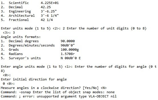

when using which function?
This is showing me when i tap pg in comand bar.
With pg i introduce some infromation for parcels

On line 2853 .. if you miss a pick it will cause this error. You always need to make sure you're passing a valid ename to that function.
Quick fix would be to include  this sub in the code:
(defun _vla-object (ename)
  (if (= 'ename (type ename))
    (vlax-ename->vla-object ename)
Then do a find and replace of 'vlax-ename->vla-object' with '_vla-object'.
  • Thanks 1

I spent about 2 minutes on the problem 😉 there are many other places this code can fail ... the OP needs to use break on error in the vlide to troubleshoot this. 11400 lines in the code posted!
  • Confused 1

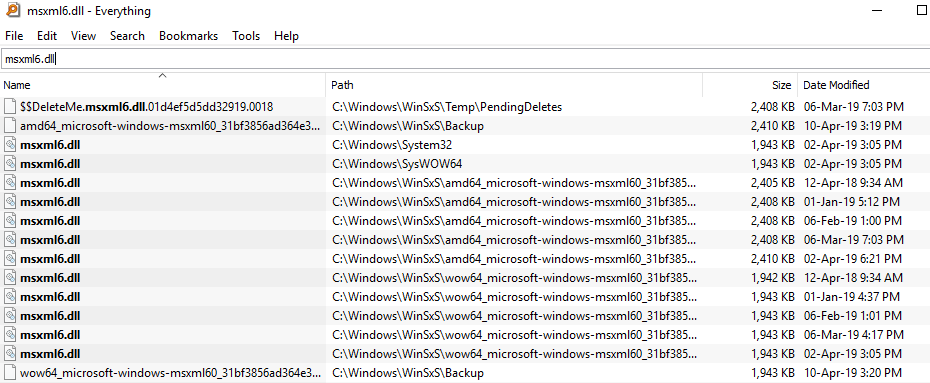

if I type PG it fails on line 11106 (c:loadxml) :
(vlax-import-type-library
        :tlb-filename "c:/Lisp-700/dll/msxml6.dll"
        :methods-prefix "xmlm-"
        :properties-prefix "xmlp-"
        :constants-prefix "xmlc-"
I don't have file "c:/Lisp-700/dll/msxml6.dll" ... do you?
google tells msxml6.dll can be installed by user for a number of products : Windows Server 2003 servicepack 2; Windows XP servicepack 2 , what it's for...I dunno exactly.
But besides code from OP is long , its in a foreign language and its poorly (not!) documented so chances of ever fixing something aren't that good either.
Hey people about this PG comand i kind a solved the mistery, it have give the error because i didn't loaded properly. I never used this lisp.
So it's ok like this, and i have "msxml6.dll" file that rlx mention about.

If you want just a little bit to work then open two notepad, in one your code, in the other paste each defun section of code for the command you want then it can probably be debugged. Make a small version of the code is what I am saying.
you will have to look carefully at each line put each called defun inserted at top of code, the layout defun should be the last one.
Which command do you use to start .
Edited by BIGAL
HEY guys its works now i think there is no problem. It was all about my autocad, i have to uninstal and instaled again. The code its good.
