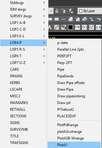

BIGAL Posted May 3, 2019 Posted May 3, 2019 (edited) I run it as a menu option, [Plot - plotter]^c^c^p(load "Plot-range-plotter") it will autorun as the last line calls the program. (AH:pltlays) same for a toolbar icon etc. Please note as it uses a window you will need to change the window co-ords to match your title block, -6,-6 807,560 and it must have your plotter name and ctb etc. I do have a move all titles to 0,0 if you need it. Any probs just ask here. Edited May 3, 2019 by BIGAL Quote
