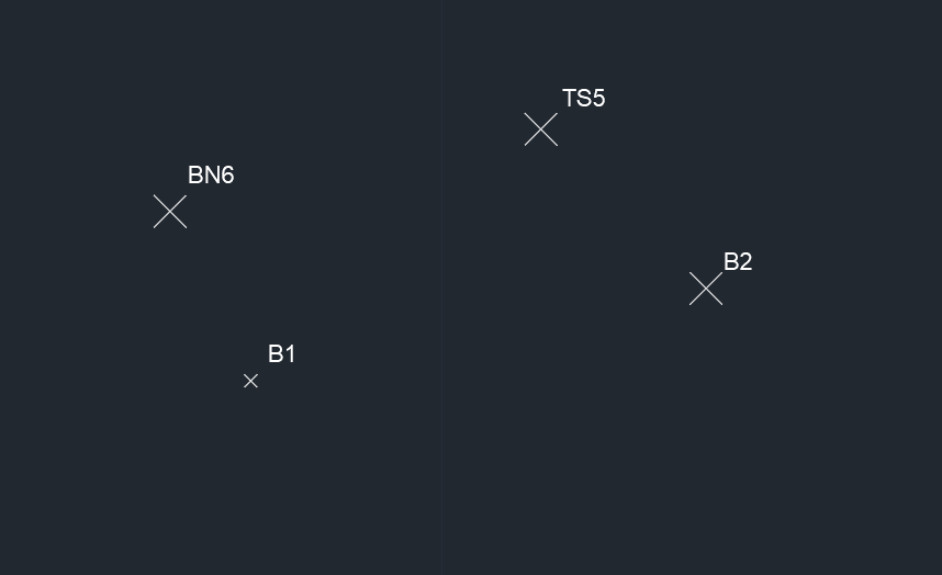

Hi all,
I need a code to create list from coordinate of each point with nearest text,
for example = ((x y BN6) (x y TS5) (x y B1) (x y B2))
x,y is coordinate of each point.
Can someone help me??
Thanks in advanced.
Point.dwg

Weird, I tried it on your dwg attachment, it works on my pc.
Did you try it on that dwg? Maybe there's something different with the dwg you really want to use it on
Sorry,  I was running it on another file, I again tested it and works well, thanks a lot.🌹
