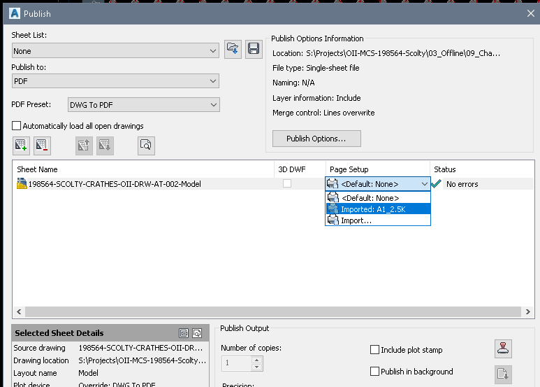

each time  I publish a DWG I always need to reload the settings, even though I do this action 10 times per day. I didn't see any save setting option in the window,
Publish:  and then I always need to select the page setup from an older DWG ...    is there a way to save the settings?
This is why I have custom plot routines. Just pick from menu and work every time.
How many title block styles and printers.
Edited by BIGAL
ok so each time i need to browse and select it?
Explain more what it is your doing model, layouts, selected layouts different title blocks, etc. Maratovich has a good plot routine.
If you leave it as default, it will use the current page set-up in the drawing. If you want to be sure you are using a proper set-up, create named page set-up(s) in the drawing and they will appear in that list.
