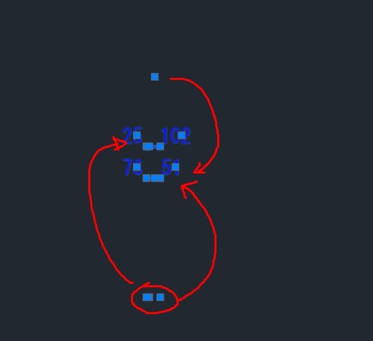

Hello everyone,
Please help me a lisp to move all points of dimension to each of dimension line of them.

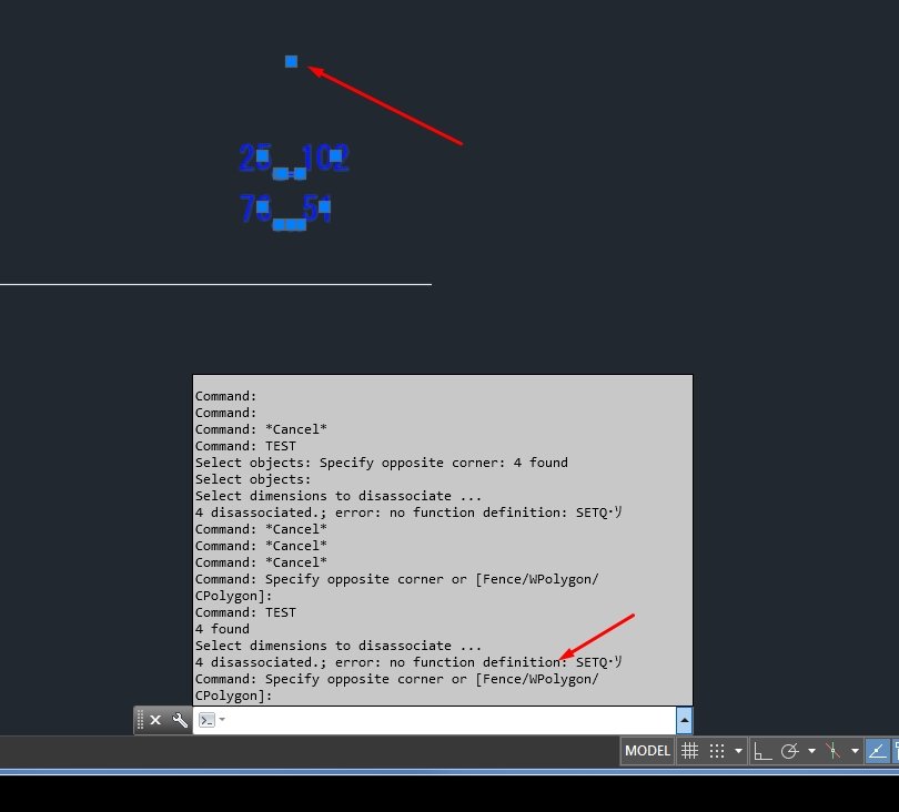

haisagiviz
19 minutes ago, Roy_043 said:
Here is a solution for AcDbAlignedDimension and AcDbRotatedDimension objects (adapted version of code published here).
Hi Roy,
Thank you so much for your help,
But it is not working for me. Please confirm by attach image file.

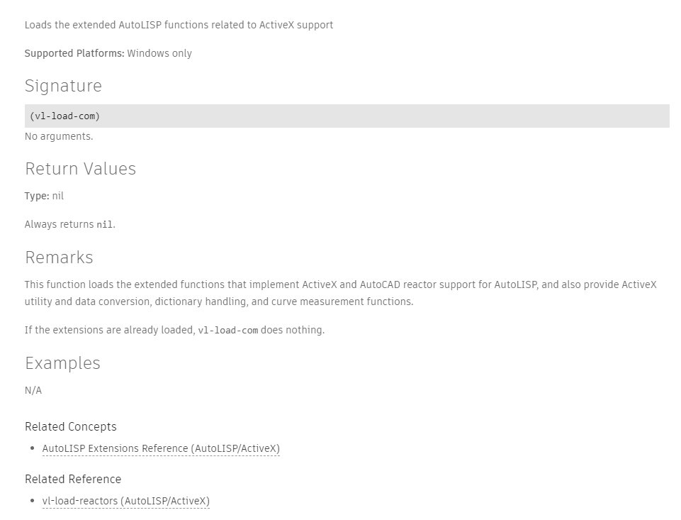

Roy_043
I have added (vl-load-com) to the code in my previous post. This is required for AutoCAD, but not for BricsCAD (which I use). Hopefully this will fix your issue.

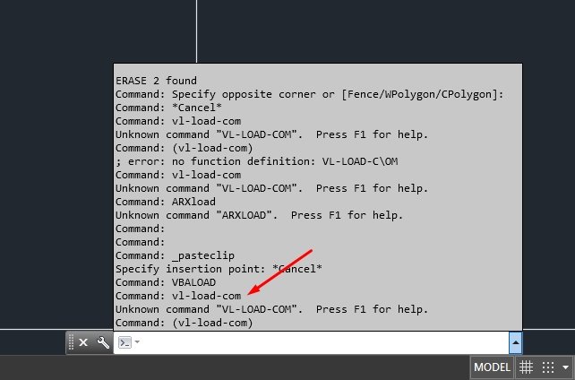

haisagiviz
I just try to load vl-load-com but sorry I cannot understand how to load it. Can you explain to me how to load it? I'm using AutoCAD 2019.
I'm just using Lisp but not yet made any Lisp myself before. I want to learn how to create Lisp for more performance my workflow.
Thanks again.
Share this post
Link to post
Roy_043
I have revised the code. Just copy-paste all of it again. And then load the revised .lsp file.

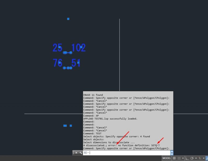

haisagiviz
Thank for your kind.
Sorry it also cannot working.

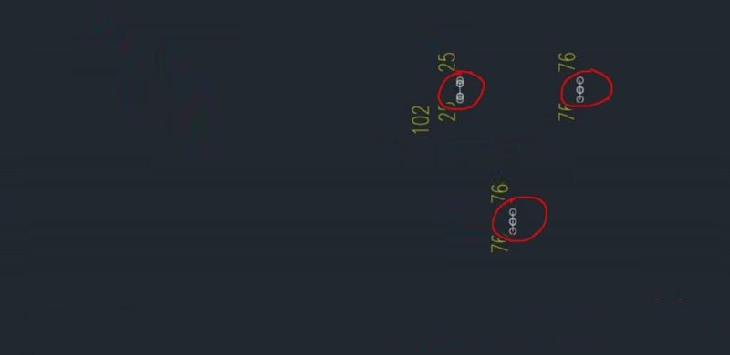

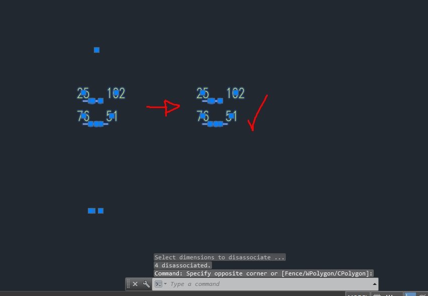

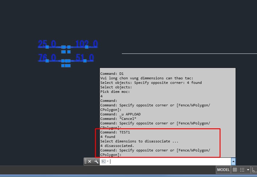

haisagiviz
@Roy_043 you are amazing! It was working for me.
But my Dim have a little problem because I exported the DWG drawing from BIM software (ArchiCAD) and the dimension have a issue need to solve as attached image.
BTW it worked as I expected, so thank you very much. I will learn from your lisp.
