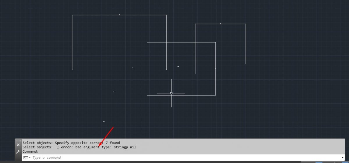

Hi everyone,
Please help me how to create 2 selection set (one of "MTEXT" and one of "DIMENSION") from this code I made.
   (setq ss3 (ssget ":L" '((0 . "MTEXT,DIMENSION"))))
Thank you so much.

Hi Lee Mac,
Thank you so much. You are always be my idols ^^
Sorry but I tested and nil for result. Please help me about that.
Command: test
Select objects: Specify opposite corner: 13 found
Select objects:
Error: bad argument type: numberp: nil
Best regards,

Thank you for your kind words.
Are you testing the code exactly as posted?
As I cannot seem to replicate the issue you are encountering and see no reason for this error.
Lee
I'm sure I copy exactly as posted because I understood how it work.
But I cannot realize where the error is.

I suspect that there is indeed an issue with how @haisagiviz copies code. Maybe this is due to an online translator? Or maybe the code is not saved to a plain text file? In another topic I ended up attaching a Lisp file.
Edited by Roy_043
  • Thanks 1
I think you're probably right Roy; I've also noticed that copying code from the forum can occasionally include invisible characters which appear as part of the code (usually at the end), which are then rendered as question marks in the IDE - I think these are caused by the 'Quote selection' link which appears.

Very thank you Roy and Lee Mac,
BTW I will type again from plain text. It is worked for me (Maybe error when copy from browser as Roy said)
I understood how to filter my selection set.
Thank you very much.
