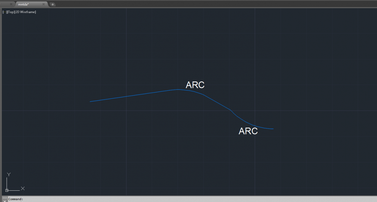

Hello all
I have 1 LWPOLYLINE
Is there a LISP to find the highest or lowest value of the Y axis  POINT on the ARC S  IN polyline ?
condition should not be the beginning or end of the bow
AND picture

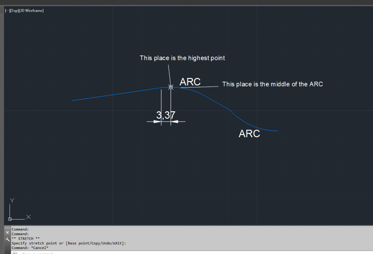

hosneyalaa
It does not have to be the middle of the arc is the highest point
Except in a special case
Sometimes
Near the middle or beginning of the arch or end
Edited by hosneyalaa

Lee Mac
Note that @eldon constructed the line vertically from the centre point of the arc, not the middle of the arc segment:
Edited by Lee Mac

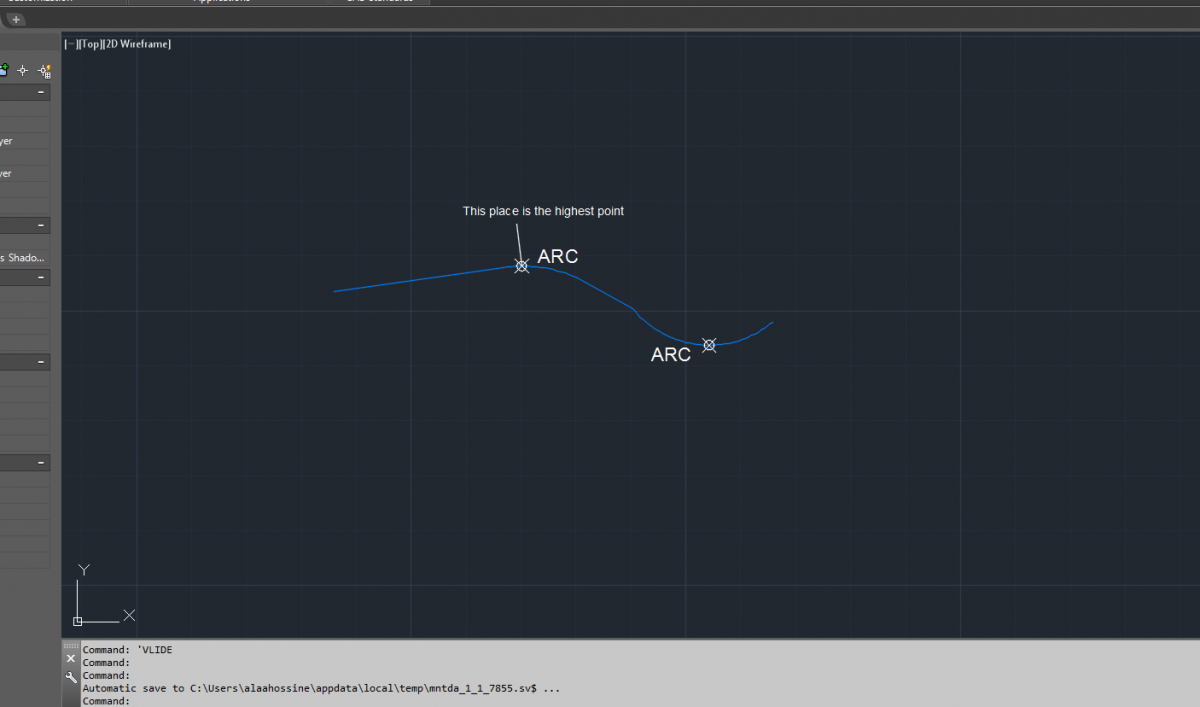

hosneyalaa
Thank you everyone
marko_ribar
eldon
Lee Mac
Responses to the topic and interaction with me
Try to create lisp and have reached the required
However, the exact needs of the experienced people may include errors due to lack of experience in lisp
I thank you again for the subject
this lisp
 I changed it
I am not his writer
The lisp  is to create points only on the arc's

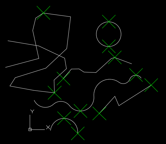

ronjonp
4 hours ago, BIGAL said:
If we break it down into individual arcs then would bounding box give correct answers ?
Or not even break it up :) .. although this doesn't just check arcs.

Lee Mac
When applied to the entire object, the bounding box approach will only yield the global minimum/maximum, not the local minima/maxima such as the high/low points of the arc segments which lie inside of the bounding box - of course, this is only my interpretation of the OPs requirements - your code may be entirely suitable.
