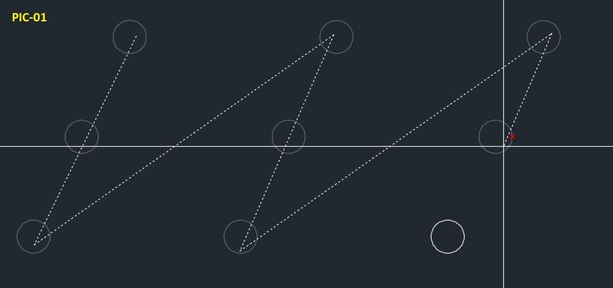

Draw PLINE between Circles center point (using FENCE)
RashidAziz
Hi
I need AutoLISP to make PLINE between Center Point of all selected CIRCLES (with FENCE option)
Like
PIC-01 (Select CIRCLES with Fence option and also use the same Sequence to Draw PLINE in Center of Circles)

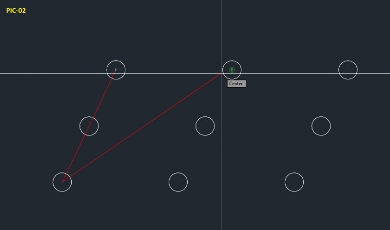

PIC-02 (Showing Pline Path)
PIC-03 (Showing final Result. Start of Pline from First Selected Circle, then Continue as selected)
Thanks so much in Advance
Try this. It asks you to construct a pline using grread and grdraw, and uses the coordinates from this to generate a list that can be fed into the fence selection of a selection set. You don't need to click inside every circle, just crossing part of it will do. The generated pline imitates the order of the previous line but connects the centres of the circles.

Your LISP working fine.
Thanks so much dlanorh.
Sir kpblc
Thanks so much. I add c:T1 and using "F" for selection and now working fine.
Thanks again both of you.
