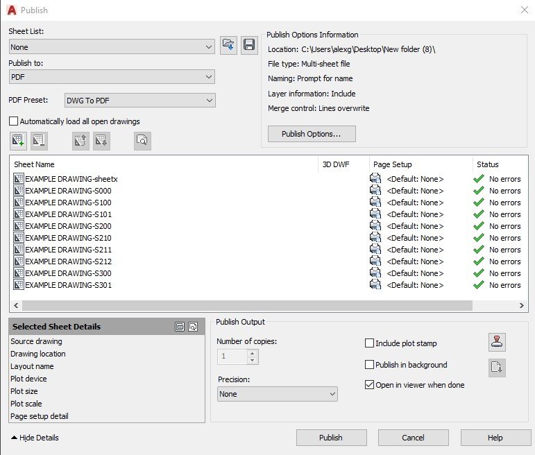

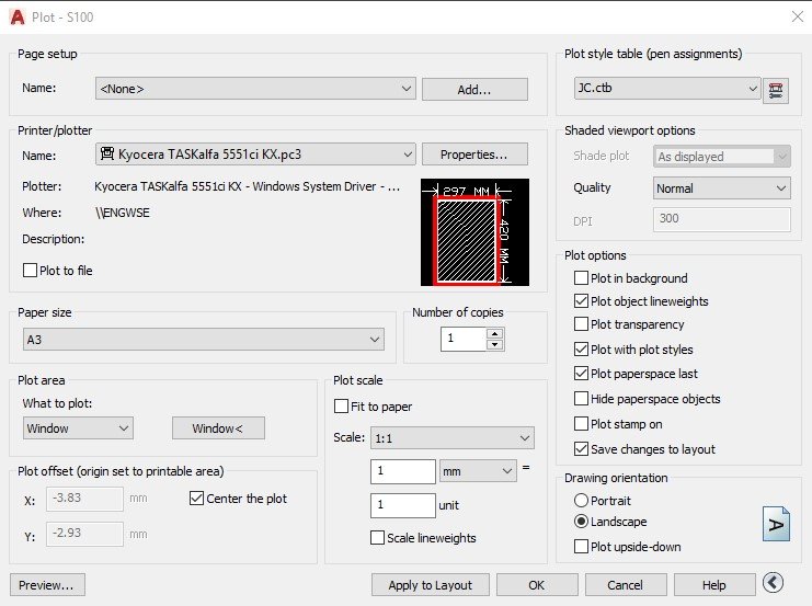

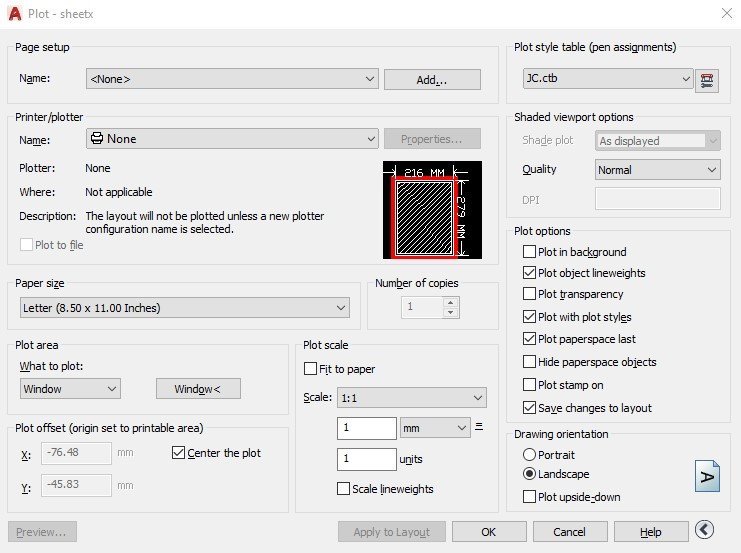

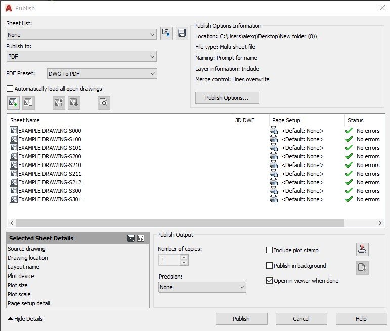

so i've worked out a way to do it but its not a method i want to stick with..
when i publish, if i have a sheet with a dud print setup as my first sheet(PUBLISH SETUP1.jpg), all the following sheets with correct print setup come out correctly (EXAMPLE DRAWING1.pdf). i then need to remove the first sheet from my pdf
if i don't include the sheet with dud print setup (PUBLISH SETUP2.jpg), all the sheets come out incorrectly(EXAMPLE DRAWING2.pdf)
i have attached the dwg i've used (EXAMPLE DRAWING.dwg) as well as picture of proper print setup (PRINT SETUP-proper.jpg) and picture of the dud setup (PRINT SETUP-sheetx.jpg)

Having saved named page set-ups is the way to get consistent publish results. Using <Default: None>  tells you nothing about what the current page set-up is. You can either have the named page set-ups in your files or they can be easily imported and applied to the drawing list.
I agree with named page setups all the way. Do it right once and it will work forever etc.

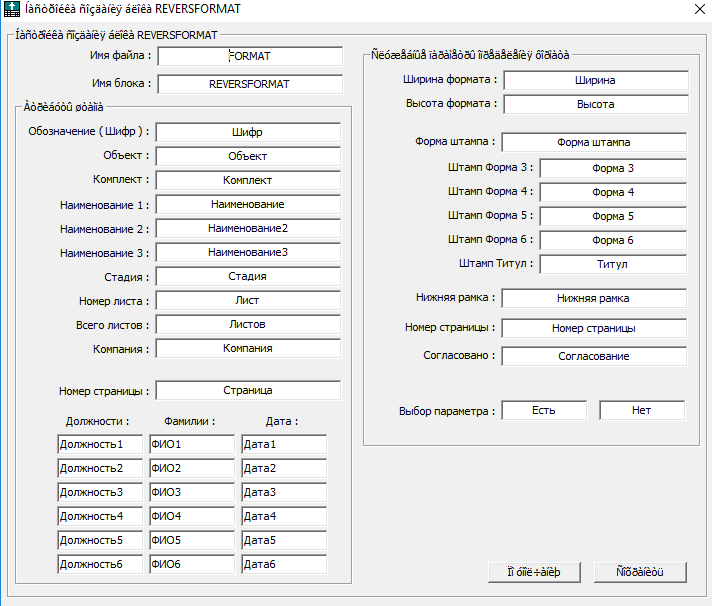

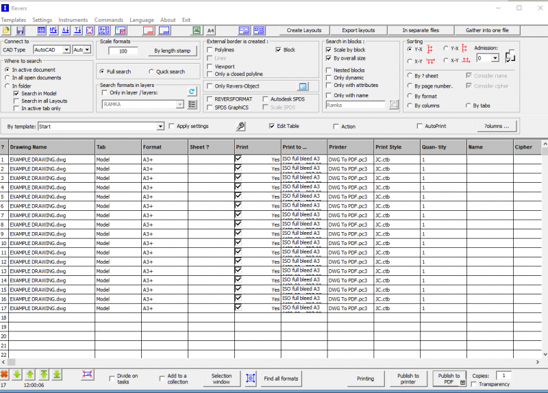

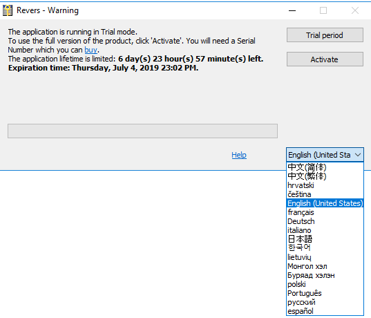

i'd actually downloaded/installed revers a month or 2 ago as it seemed like something i'd find extremely useful but i gave up with it because when i went to use it it was in different language and couldn't work out how to change it to english. not sure if i still have installed or not. was gonna see if i still have installed and then get back to you and see if can get it working properly
Link to post
masterfal
27 minutes ago, maratovich said:
This is English version - Revers
pretty sure thats where i got it from..
just tried installing here. still getting non english

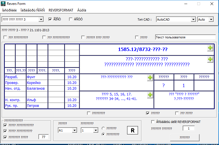

maratovich
Did you watch the video?
This module is not translated - you do not need it.
This is for the automatic creation of the title block.
You need a module to print.
You need to run the blue label of the Revers program.
The label is called Revers

masterfal
so strange. its working now
surely i tried both icons before.. maybe not
oh well i'll try it out tomorrow. hopefully it works. do you know if there are any extra functions or anything on full version compared to trial?
really appreciate your help. i'll let you know how i go
