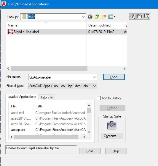

Argh! I must be doing something wrong then. When I go to load the lsp file the attached is a shot of what I'm seeing telling me it's unable to load the file. Is it me or is it the software I've got?Thanks folks for your help so far :)

I've got the .lsp file saved in the same folder as the .dwg (just in case) and that's not made a difference. It was a .dxf but now is a .dwg, no difference. What on earth am I doing wrong?!?
It looks like the LSP file is not in a location where AutoCAD expects it to be. Go to Options|Files and look at the folders under Support File Search Path or Working Support File Search Path. Your code file should be in one of those folders, such as "support." Put a copy there and try loading the function again.

That will not work in recent versions of AutoCAD.  Put it in a folder in Options → Files tab → 'Support File Search Path' that's also in 'Trusted Locations'.

If you open explorer find the lisp file that you saved via notepad you can drag and drop onto the open Autocad dwg a message will appear about trusted location just click Ok and it should then run. I just copied from here to notepad, saved and dragged to a dwg and it worked.

I think I may have figured out why it's not working. Our workstations are locked down so we cannot do much without administrator rights. I cannot save a file to the trusted locations listed and if I try to add a location I get an error message stating "The directory specified for log files must exist and have read/write permission. The value previously saved for the log files directory will be used."
Sadly, I think it's a good old fashioned case of computer says no
Try drag and drop , then chase IT to give permission to add files to say a network directory, they can open lisps and look for paranoid words like delete, file. Lisp is not a hard language to read.
