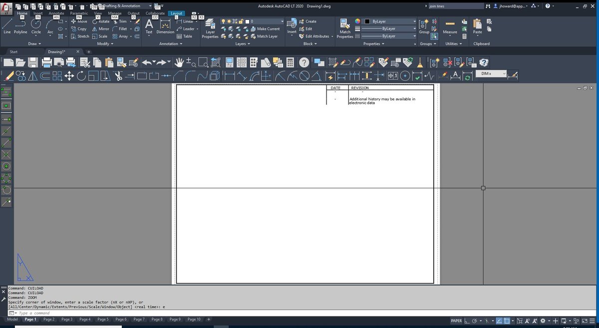

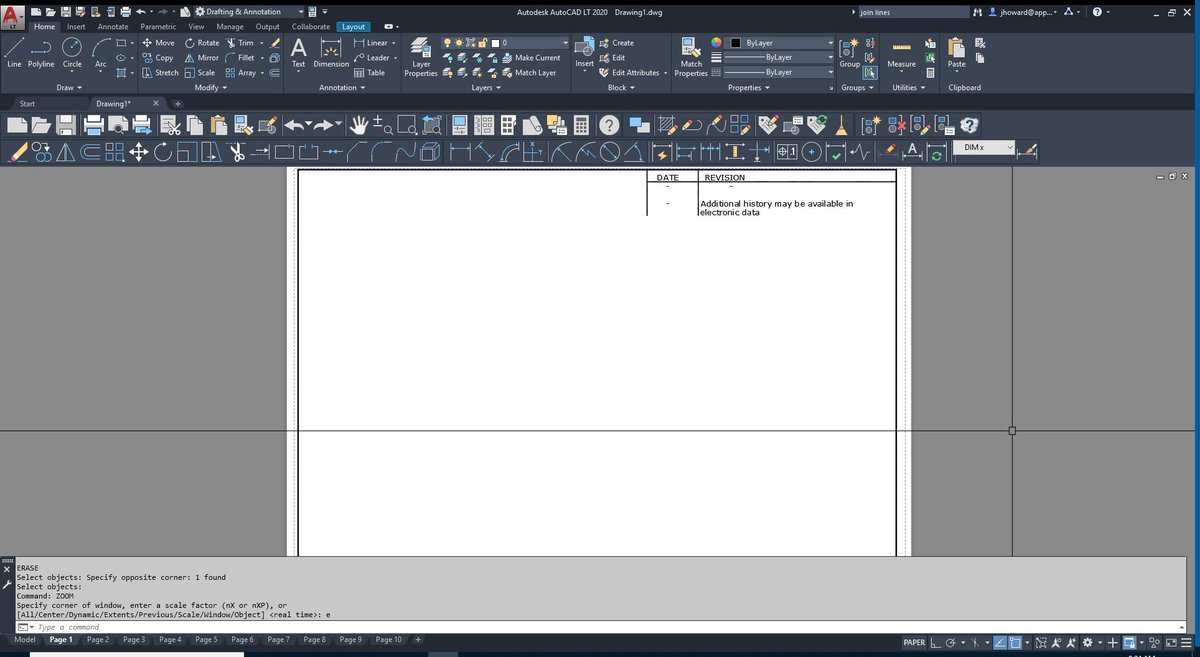

Autocadbuddy4095 Posted November 25, 2019 Share Posted November 25, 2019 On 10/28/2019 at 12:44 PM, RobDraw said: This thread was started in 2019. Maybe you wanted to say "And now it is October"? Did you have a question about docking the command line? Yes - I meant to say 'And now it is October 2019' And yes, I had a problem trying to dock the command line. Somehow I was able to solve this accidentally (?) Only issue I have now is when I zoom out to extents, My CAD model space goes 'behind' the command line. Shouldnt the command line be part of the window (frame) and be able to see ALL of the model space and the command line ? This is how I would like to be set up. What should I be doing ? many thanks in advance ! Quote Link to comment Share on other sites More sharing options...
Cad64 Posted November 25, 2019 Share Posted November 25, 2019 55 minutes ago, Autocadbuddy4095 said: Only issue I have now is when I zoom out to extents, My CAD model space goes 'behind' the command line. Shouldnt the command line be part of the window (frame) and be able to see ALL of the model space and the command line ? This is how I would like to be set up. What should I be doing ? I'm a little confused. Can you provide some screenshots of what's happening before and after you zoom extents? Quote Link to comment Share on other sites More sharing options...

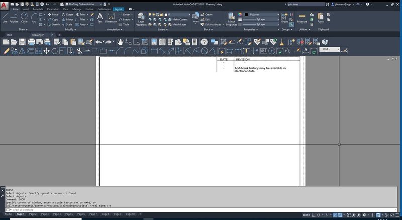

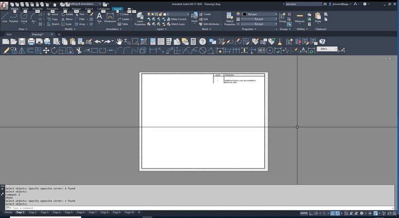

steven-g Posted November 25, 2019 Share Posted November 25, 2019 If zoom extents puts part of the drawing behind the command line, then the command line isn't docked properly, you don't just drag the command line to the bottom edge until it sticks, you have to drag it down below the model/layout tabs and then you see a dotted outline over the full width of the program window and release it there, it does jump back above the tabs but it is now properly docked. Quote Link to comment Share on other sites More sharing options...
Autocadbuddy4095 Posted November 27, 2019 Share Posted November 27, 2019 CAD-64: I have made screen shots . . . SC-1 and SC-2 illustrate my problem where you can see the command line obstructs the drawing along bottom of dwg border. Then I tried steven-g's suggestion and it worked ! (SC-3) Holy Cow ! I'm ashamed to tell you how long I had to put up with that. I couldnt find ANYTHING in the Autocad Help section at all . . . THANK YOU SO MUCH Steven=g !! You're the hero today ! Quote Link to comment Share on other sites More sharing options...
