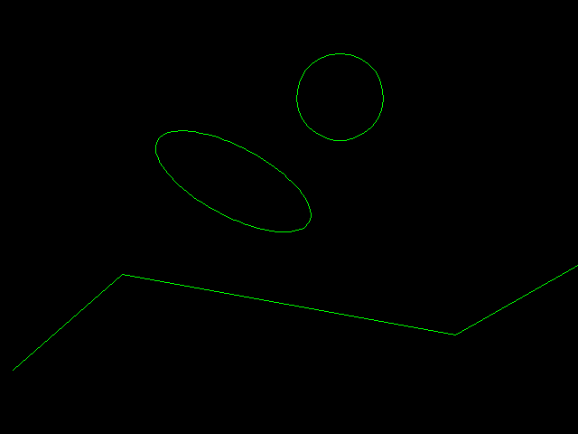

Hello all the members
 please help
Find a code Dynamic drawing a line to  poyline  perpendicular
on this link
http://www.theswamp.org/index.php?topic=12813.30
Is it possible to change the lisp ?
When we choose a point
The lisp ends working
After drawing one orthogonal line
It gives the length of the line
And
Coordinates of the selection point
And
Location the selection point left or right of polyline
Thanks!

Not exactly sure what you're asking but give this a try:

I want to stop working  function while
I do not want to continue function while
Give the result only one time
if possible
Try the following:
