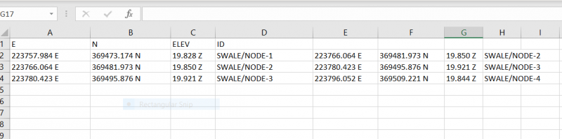

The first step is to make columns of the blocks, you can then copy and paste the second set of columns.

 i need to update Same template, There is ATTOUT also but i need in This Excel Template

I did dataextraction made a csv opened it in excel and made this took a couple of minutes.
