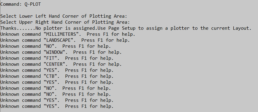

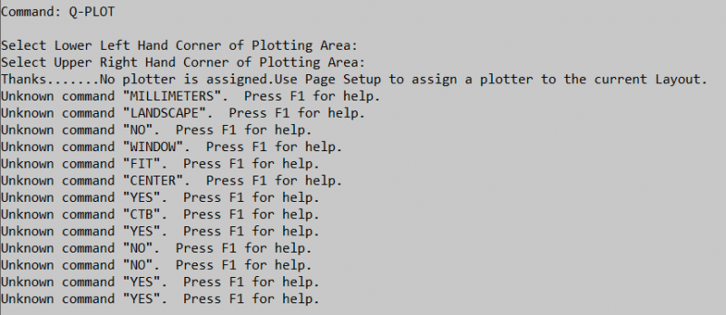

@rkmcswain Thanks for your help.
It is working great for PDF plot, although pdf plotted does not have same name as dwg. I want the pdf to be as same name and location as that of dwg file.
We tried to use this code for plotting PNG after adding our plotter and .ctb style but it is giving the below error.image.thumb.png.4c7eca66ec13d768599b3e9345d02f1d.png
Below is the code modified by me for plotting PNG
q-plot.lspq-plot.dcl
