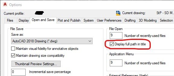

RobDraw Posted July 25, 2019 Posted July 25, 2019 (edited) It should be there. The only option I can think of concerning that is whether or not to display the full file path which might make it too long to show the file name. If this is the case, see screen shot below. Edited July 25, 2019 by RobDraw Quote

deano33 Posted August 23, 2019 Author Posted August 23, 2019 Thanks Rob but already tried disabling display full file path and didn't resolve the issue. Quote

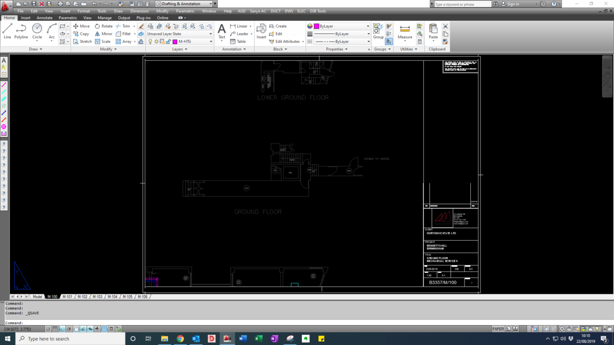

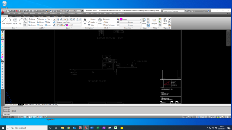

deano33 Posted August 27, 2019 Author Posted August 27, 2019 Screen shots attached. Yes its maximised but doesn't appear clipped by screen limits. Quote
RobDraw Posted August 27, 2019 Posted August 27, 2019 Does that mean you do see it when the window is not maximized? I've seen this recently in the Autodesk forum. I think it has something to do with display scaling for 4K monitors? Quote

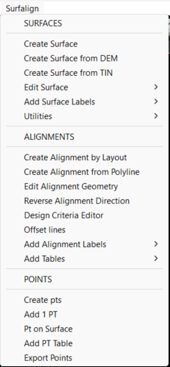

BIGAL Posted May 23, 2024 Posted May 23, 2024 (edited) A good idea is to save Workspace say as your name then if you add custom menu's etc keep saving that workspace then you have default if you need it. A side note I used CIV3D with Drafting and Annotation as my default, but I made custom pop menu of CIV3D commands that we used a lot so did not have to keep swapping workspaces. You can copy the correct command call from the CUI into say a new custom .mnu. Then use menuload to add it. Edited May 23, 2024 by BIGAL Quote
