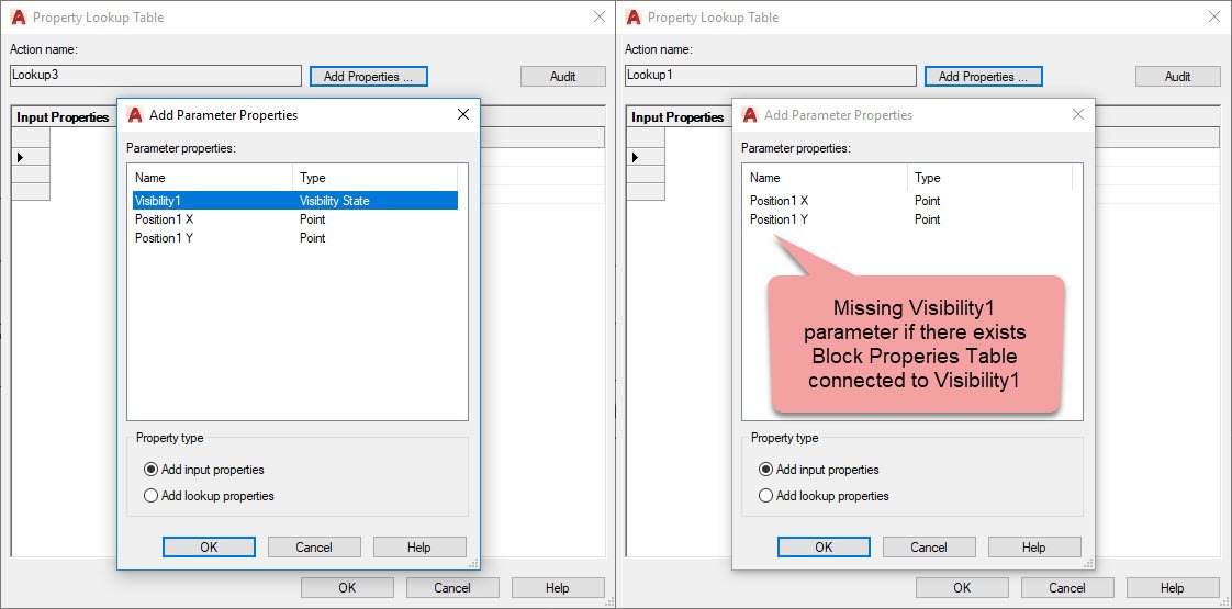

Jozef13 Posted August 14, 2019 Share Posted August 14, 2019 Hello everyone, is it possible to change attribute value and its position based on visibility or lookup parameter ? I am able to do only one of these as you can see in attached dwg. Best Regards. MoveAtt.dwg Quote Link to comment Share on other sites More sharing options...

Jozef13 Posted August 14, 2019 Author Share Posted August 14, 2019 1 hour ago, danellis said: Use a field in your AttMove block (as opposed to one of the others) - i.e. the one where you'd gotten the position to change but not the value: Forgive me if you know how to use fields, but in case not: In the Block Editor; Clear out the Default value of the attribute, and use Ctrl^F to insert a field; On the left-hand side, click on the BlockPlaceholder field name (you may find this easier to find under the "Objects" field category); In the middle Block Reference Property box, the bottom item should be Visibility1 - select this; Apply any formatting you want and OK out. This won't work with any versions of the block currently in place, but if you insert a new one, it will... dJE Thank you for your advice, but I need to achieve that functionality. Described functionality I need for more complex blocks. The sent block was just a simple attempt to define the desired behavior. The problem is that when I use a block property table in a block definition, the visibility parameter is not available in Property Lookup Table and I can not add it as property as you can see at attached jpg. Quote Link to comment Share on other sites More sharing options...
Jozef13 Posted August 14, 2019 Author Share Posted August 14, 2019 I have already solved the problem by adding Point Parameter Properties directly to Block Properties Table and omitting lookup MoveAtt.dwg Quote Link to comment Share on other sites More sharing options...
