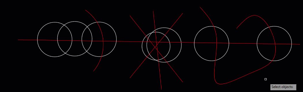

After running the program recently, the circle will be lost and the cutting will not be complete. See the attached figure!After running the program recently, the circle will be lost and the cutting will not be complete. See the attached figure! Which friend can help me solve it?

The center lines of the structural members do not intersect at the center of the nodes. The green 'trim' lines that seem based on those center lines are also inaccurate. If you zoom in it is rather obvious.
Edited by Roy_043
On 8/18/2019 at 4:34 AM, Roy_043 said:
结构构件的中心线在节点中心不相交。基于这些中心线的绿色“修剪”线也是不准确的。如果你放大,这是相当明显的。
ROY, it is, but is there any way to ignore this? Because some profiles are the output of the calculation software!Thanks
If the lines in the original drawing are inaccurate, then no doubt the circles (the nodes) are also. These inaccuracies are likely caused by a rounding of coordinates. You should first check if the output from your 'calculation software' can be improved.
If this is not possible I would assume that the centers of the circles are correct and modify the lines so that they run from center to center.
The code published here can be modified to accomplish that.
Edited by Roy_043
Hi,Roy!
Can you help me to modify it? Because I write programs that rarely use VL to complete, it leads to unfamiliar use of VL functions.

Maybe I explained a bit confusing. The original program I wrote was to process circles and lines by inserting two graphics (120_Line.dwg, 120_GJ.dwg) at the specified position.

HI,Roy!
You look at my drawing (120_Line.dwg), there is a problem with the insertion of the round cut (the circle is missing or the cut with the inserted line is not complete or the cut between the inserted lines is not complete), I really don't know how to deal with it. , your program, I have modified the tolerance as you said, (Code)and it runs very well, can you follow the drawings I provided?
HI,ronjonp
Can I write the program according to the drawing I provided (Test_2.dwg), according to the inserted drawing (120_Line.dwg, 120_GJ.dwg), or directly in the program without considering the inserted graphics.
Edited by myloveflyer
I assumed you were looking for an explanation as to why your code failed. But apparently you already knew why (although you failed to mention this in your OP) and you actually want someone to rewrite your application. I am not willing to do that. At least not as a free service.
11 hours ago, Roy_043 said:
我以为您正在寻找一个解释为什么您的代码失败。但是很明显,您已经知道了原因(尽管您在操作中没有提到这一点),而且您实际上希望有人重写您的应用程序。我不愿意那样做。至少不是免费服务。
Hi,Roy!
Sorry to bring you trouble, I just want to know that my program is wrong in that place, correct that part of the program can eliminate the error, if necessary, I will pay a fee!
I think you can solve your own problem if you create regions from the circular nodes and then subtract rectangular regions (using the _Subtract command) to create the flat areas. The rectangular regions can be put in a block similar to what you are doing with the "120-48-20" block. And they can be oversized to avoid accuracy problems.
Hi,Roy!
I am going to rewrite this code, do not insert the file processing from the outside, draw the required graphics directly inside the program, I don't know if I can write successfully, if I don't understand, I still need to ask you.
IMO this is not a good idea. Using blocks for this task is the obvious way forward. I would never explode the "120-48-20"  blocks.
