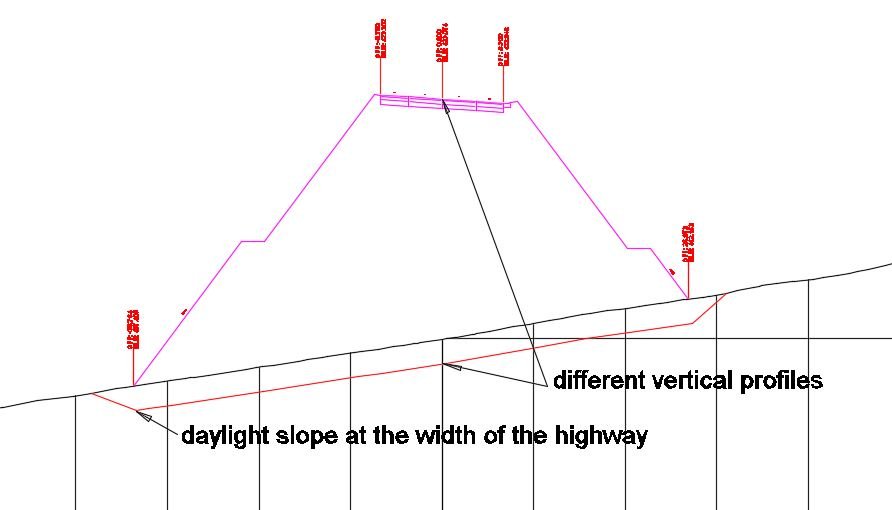

bsimpson Posted August 26, 2019 Share Posted August 26, 2019 The stock subassembly "stripping pavement" is similar to a subassembly I need. Can I compose a similar subassembly in the subassembly composer? The subassembly needs the following; 1. No constant depth for topsoil. 2. Follow the existing surface in cross section. 3. daylight or stop at the width of the highway. 4. a different vertical profile than the road corridor Quote Link to comment Share on other sites More sharing options...

bsimpson Posted August 27, 2019 Author Share Posted August 27, 2019 I managed to write the subassembly using SAC using the special feature surface link, it is attached. Mysurfacelink.pkt Quote Link to comment Share on other sites More sharing options...
