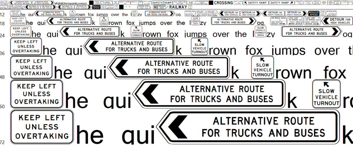

abraxus Posted September 5, 2019 Share Posted September 5, 2019 I have looked all over the place trying to figure out how to create a SHX file to use in AutoCAD that has each shape in the file mapped to a key and I am not having any luck. Perhaps someone here will know how to do this. I apologize if this has been covered somewhere already. If that is the case, please just link me to where this is explained. I know how to create a shape file using MKSHAPE. I know how to convert the SHP file to a SHX file using CONVERT. I know that SHX files have to be in a FONT folder within the AutoCAD folder. But none of this explains how to create a SHX file that I can use in the MTEXT command for example so that when I type the letter A (for example) the custom shape I created for the letter A is displayed, and the same for B and so on. Is there a program I need to use to help me create such a file? If not, what is the process I would have to go thru manually to create what I need? Quote Link to comment Share on other sites More sharing options...

rkmcswain Posted September 6, 2019 Share Posted September 6, 2019 On 9/4/2019 at 10:31 PM, abraxus said: I have looked all over the place trying to figure out how to create a SHX file to use in AutoCAD that has each shape in the file mapped to a key and I am not having any luck. Have you seen this? It explains how to tag the SHP file so that AutoCAD knows it's a font file and not a shape file, and that each character definition must be coded using the ASCII code for the desired character. For example, "65" is an upper case "A" *65,11,uca 024,043,04d,02c,2,047,1,040,2,02e,0 Quote Link to comment Share on other sites More sharing options...
BIGAL Posted September 7, 2019 Share Posted September 7, 2019 I still think going to ttf may be be better as the font convert uses vector input which Autocad basically is. Like every one need time to play. Any way a handy hint (ascii (getstring "enter character")) type a 97 revealed. type this command line (ascii (getstring)) I use copy and paste so can repeat Quote Link to comment Share on other sites More sharing options...
abraxus Posted September 7, 2019 Author Share Posted September 7, 2019 Thanks, rkmcswain That does help a bit, although it does seem a bit complex. 1 Quote Link to comment Share on other sites More sharing options...
BIGAL Posted September 8, 2019 Share Posted September 8, 2019 *97,11,lca 024,043,04d,02c,2,047,1,040,2,02e,0 use character "a" it has 11 items its name is known as lca *65,56,ARROW 4,250,4,4,3,29,3,55,3,243,002,9,(8,5),(0,0),001,9,(108,0),(-43,43),(15,0),(48,-48),(-48,-48),(-15,0),(43,43),(-108,0) (0,10),(0,0),002,9,(-8,-5),(0,0),001,4,243,4,55,4,29,3,4,3,250,0 Just add more items *66,6,BOX 014,020,02C,028,014,0 1 Quote Link to comment Share on other sites More sharing options...
