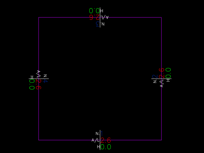

Hi to everyone,
I´m a "new old" user here. I just  forgOt my old user name 😉 my last visit here was in 2008, I think.
I started working again with AutoCAD for BOM in civil building.
Now I need a big help.
Starting from the LISP of Lee MAC, "MidLen V1-1.lsp", I need  the value of the generated field, which contains the length of an object, to be directly written in an attribute (contained in a block, of course) AND, at the same time, to increment the number of another attribute, of the same block, to recognize univocally the object (the length). At the end, after selection of the lines, must be generated one block for each, numbered univocally with the length of the line.
The example attached can have anoter design, just with two attribute, no graphics.
I know there is a LISP called "LengthFieldToAttribute V1-0.lsp", but you have to pick each line and pick the attribute in the block to write the value in it.

Davide
Hi BIGAL,
thankyou for the answer.
I need to put the block at the middle of line, aligned to the line. But it is not so important.
Important is that each line is associated to the block with the measurement of line in the attribute, contained the field, AND an univoque incremental number in another attribute of the block (please not handle).
For example, it could be used in conjunction the skills of Numinc Lisp with the MidLen Lisp :
1. Select a name to be incremented, for univoque name (using the features of Numinc.lsp http://www.lee-mac.com/numinc.html)
2. Select the lines to populated the blocks with the length (using the code of MidLen.lsp http://www.lee-mac.com/midlen.html)
3. For the output: to export the value in excel, I use MacAtt.lsp (http://www.lee-mac.com/macatt.html)
Consider that the same new suite, could be used also for areas...
See attachment for better understanding.

Davide
1 hour ago, BIGAL said:
Here is a start for you, needs readability added. Block must exist.
; By alanh 2019
(defun numblkattnum ( / ss2 obj att )
(setq num 0)
(setq ss2 (ssget "x" (list (cons 0 "insert")(cons 2 "_AufMass_FEW"))))

Hi Bigal,
thankyou for the code. I´ve tested, but it doesn't work.
And I don't know what do you mean for "needs readability added."
This is the command-line output, for one line selected (the output is the same if you select more than one line at time, repeating for each item):
Command: NUMBLKLEN
Select objects: 1 found
Select objects:  -insert Enter block name or [?] <_AufMass_FEW>: _AufMass_FEW
Units: Unitless   Conversion:      1.00
Specify insertion point or [Basepoint/Scale/X/Y/Z/Rotate]:
Enter X scale factor, specify opposite corner, or [Corner/XYZ] <1>: 1 Enter Y scale factor <use X scale factor>: 1
Specify rotation angle <0r>: 0
Command: 1 Unknown command "1".  Press F1 for help.
Command: 2.6 Unknown command "6".  Press F1 for help.
Command: 0.0 Unknown command "0".  Press F1 for help.
Command: 0
You can see the result in the attached file.

Davide
Ciao Bigal,
yesterday I'we tested the lisp without Radio Button, and it works!!!
See the attachment.
The new version with radio button have some problem: after giving the path to autoload "Multi Radio Button.lsp", the new "numblklen.lsp" work only once and, at every instance is going to write the length of line in the block, appear the GUI for the "Appload" command. With the "ESC" (escape button), the routine works anyway, and as told, write the block, but, at the end the command "numblklen" is not more available.
Summing up:
1. The lisp "numblklen v2.1"  in attachment works
2. The last version above "numblklen v3.1", works, but only one time and you have to click the "ESC" button for every line you have selected. Maybe it's depend from my computer. Hi give me some problems - even it's only one month old - with Autocad... I think something with the Noun/verb selection.
Only one think to mention: I have modified the field expression in the 2nd lisp version (the one without Radio Button) with the one of the 3rd. In fact, your last version use a different field expression that write only 3 number after the comma.
I think it will be bettere if the field will use the precision according to DDUNITS.
See the 3 version of numblklen.lsp in attachment. Version 2.2 is the 2.1 with the string for field of version 3.1.
And in the .dwg you can see the result of "numblklen.lsp". I know that it´s look a litte messy, but I need the output in excel.
For your info, I've tested the lisp with a block with more than 3 tags, and it work.
