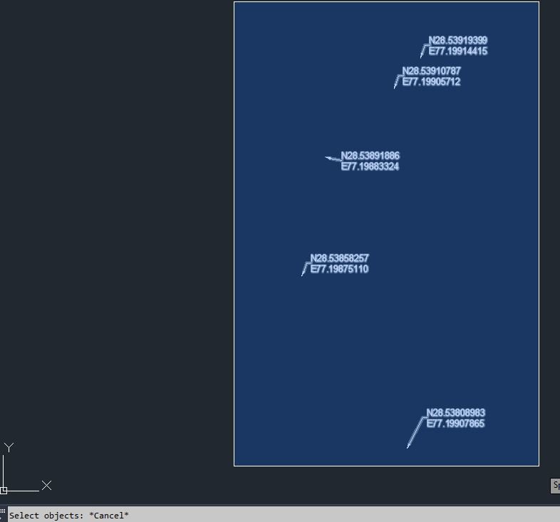

Ish Posted September 28, 2019 Posted September 28, 2019 (edited) 32 minutes ago, dlanorh said: Try the attached. This asks for a leader and an MText selection to get the layers involved and then will process every leader and MText in the selected layers. It will also ask you to set a fuzz factor as this may change in individual drawings. assocMText2Leader.lsp 2.2 kB · 0 downloads SIR, MULTIPLE SECTION NOT WORKING, IT ONLY FOR INDIVIDUAL SELECTION. SEE ATTACH IMAGE. SIR, FOR SELECTION METHOD. THANKS Edited September 28, 2019 by Ish MODIFY Quote
dlanorh Posted September 28, 2019 Posted September 28, 2019 Quote SIR, MULTIPLE SECTION NOT WORKING, IT ONLY FOR INDIVIDUAL SELECTION. SEE ATTACH IMAGE. SIR, FOR SELECTION METHOD. THANKS Please attach this drawing as a sample drawing (saved in AutoCAD 2010 format). I though I understood what you required, but I seem to have got it wrong. Do you still require the Leader to MLeader part? Does it need to work with the updated Attach MText to Leader lisp? Quote
Ish Posted September 29, 2019 Posted September 29, 2019 12 hours ago, dlanorh said: Please attach this drawing as a sample drawing (saved in AutoCAD 2010 format). I though I understood what you required, but I seem to have got it wrong. Do you still require the Leader to MLeader part? Does it need to work with the updated Attach MText to Leader lisp? for now, need only joint leader to mtext. mleader not require. i attached here cad file as you request. Leader joint to mtext.dwg Quote
dlanorh Posted September 29, 2019 Posted September 29, 2019 OK. Attached is updated AMT2L lisp. This handles 4 of the 5 leaders in your drawing. The exception is a leader with an attachment point set to 1 where the others are set to 4. This can be compensated by setting the fuzz to 3, but the leader moves. It is possible to keep the leader as is and move the mtext. What would you like to do? assocMText2Leader2.lsp 1 2 Quote
Ish Posted September 29, 2019 Posted September 29, 2019 40 minutes ago, dlanorh said: OK. Attached is updated AMT2L lisp. This handles 4 of the 5 leaders in your drawing. The exception is a leader with an attachment point set to 1 where the others are set to 4. This can be compensated by setting the fuzz to 3, but the leader moves. It is possible to keep the leader as is and move the mtext. What would you like to do? assocMText2Leader2.lsp 2.21 kB · 0 downloads wow, exactly the same what i want. Thanks -Dlanorh Rising Star Quote
