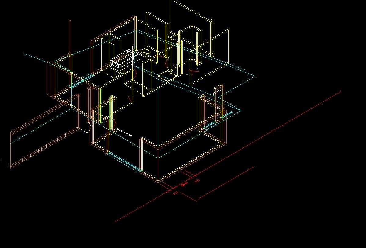

There are some door lisp's out there that will "BREAK" the wall and insert a door with arc etc. Just do a search. Some use dynamic blocks which is the way to go.
The image is from a design package add on.
Edited by BIGAL

The doors in the image punch holes in walls and are user sized not blocks, same with offset from adjacent corner.
