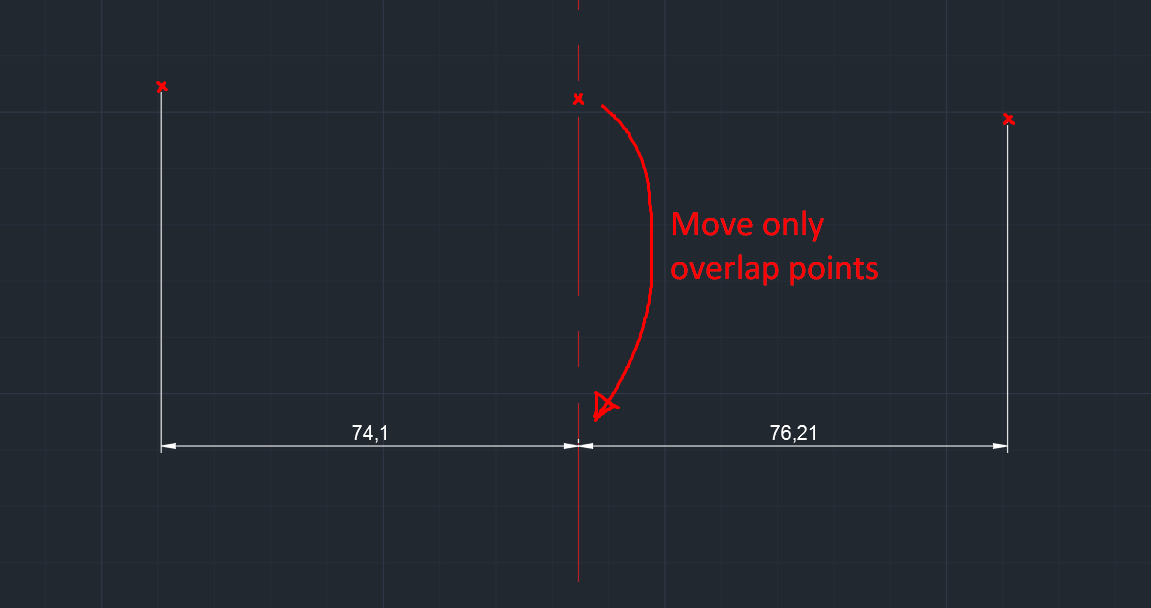

haisagiviz Posted September 25, 2019 Share Posted September 25, 2019 Hi everyone, I have a lisp to Move all of dimension point to itself base line from @Roy_043 before. The lisp is working for me and can move all of Def points of dimension to base line. But for more in the drawings, I need to move only Dim Points which are only overlap on other center line (such as line, polyline, rectangle edge...) Please download attached file. Thank you so much. HAI _PutDefPointsOnDimLine.lsp Quote Link to comment Share on other sites More sharing options...
Emmanuel Delay Posted September 26, 2019 Share Posted September 26, 2019 dim.dwg It probably doesn't do all you want, but here's a start. It works only for horizontal dimensions. If the first extension line origin of obj1 = the second extension line origin of obj2 => then it will push both points down to the y-value of the dimension line. Try it on my file first, then see if it fits your needs, let me know. ;; https://forums.autodesk.com/t5/visual-lisp-autolisp-and-general/change-the-value-of-a-assoc/td-p/8738111 ;; modify 1 property of an object (defun entmod_property (psn tag YourNewValue / ) (entmod (setq psn (subst (cons tag YourNewValue) (assoc tag psn) psn))) ) (defun c:test ( / obj ent) (setq ent (entget (setq obj (car (entsel))) )) (entmod_property ent 14 (list 10. -4.)) ) (defun samepoint (p1 p2 / small_number) (setq small_number 0.01) (< (distance p1 p2) small_number) ) ;; Move Def point on Dimension line when Overlap (defun c:mddo ( / ss i j item item2 obj obj2 ent ent2 datalist) (princ "\nSelect dim objects: ") (setq ss (ssget (list (cons 0 "DIMENSION")))) (setq i 0) (setq datalist (list)) (repeat (sslength ss) (setq obj (ssname ss i)) (setq ent (entget obj)) (setq datalist (append datalist (list (list (cdr (assoc 13 ent)) ;; left arm (cdr (assoc 14 ent)) ;; right arm (cdr (assoc 10 ent)) ;; bottom position ) ))) (setq i (+ i 1)) ) ;; now let's analyze the data (setq i 0) (foreach item datalist (setq obj (ssname ss i)) (setq ent (entget obj)) (setq j (+ i 1)) (while (setq item2 (nth j datalist)) (setq obj2 (ssname ss j)) (setq ent2 (entget obj2)) ;; look if the first extension line origin of obj1 = the second extension line origin of obj2 (if (samepoint (nth 0 item) (nth 1 item2)) (progn (entmod_property ent 13 (list (nth 0 (nth 0 item)) (nth 1 (nth 2 item)) ;; x position stays, y position of bar gets taken )) (entmod_property ent2 14 (list (nth 0 (nth 1 item2)) (nth 1 (nth 2 item2)) ;; x position stays, y position of bar gets taken )) ) ) (setq j (+ j 1)) ) (setq i (+ i 1)) ) ) 1 Quote Link to comment Share on other sites More sharing options...

haisagiviz Posted February 4, 2020 Author Share Posted February 4, 2020 (edited) Dear @Emmanuel Delay, Thank for your support. Sorry for late because I just want to learn something about basic Autolisp before start with it. I used MDDO command and tested your lisp but it is not working well. It worked but almost of dimensions went wrong. Please confirm again in my attached drawing. Thank you so much. HAI Test Drawing.dwg Edited February 4, 2020 by haisagiviz Attached the drawing file. Quote Link to comment Share on other sites More sharing options...
