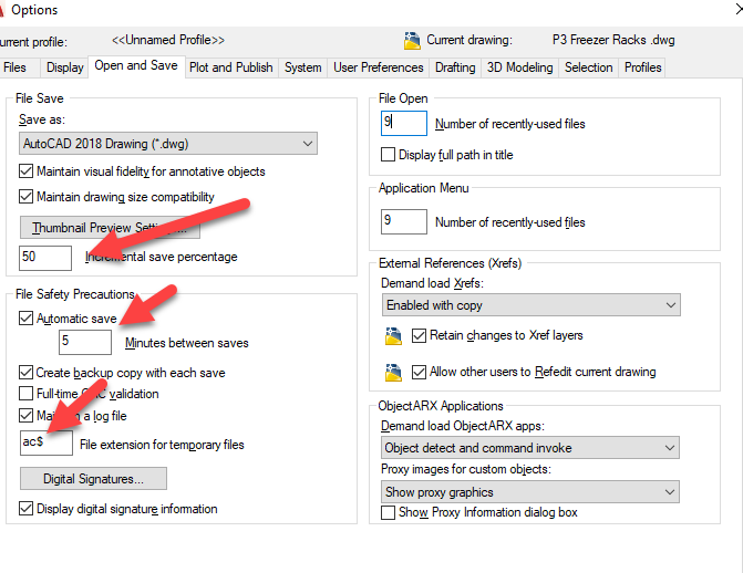

Sengna Posted September 30, 2019 Author Posted September 30, 2019 going forward, this is what i have set under CONFIG, let me know if you have anything that you can recommend me thanks Quote
Sengna Posted September 30, 2019 Author Posted September 30, 2019 sorry i renames the file extension to "SV$", so the screenshot above is not it. Quote
