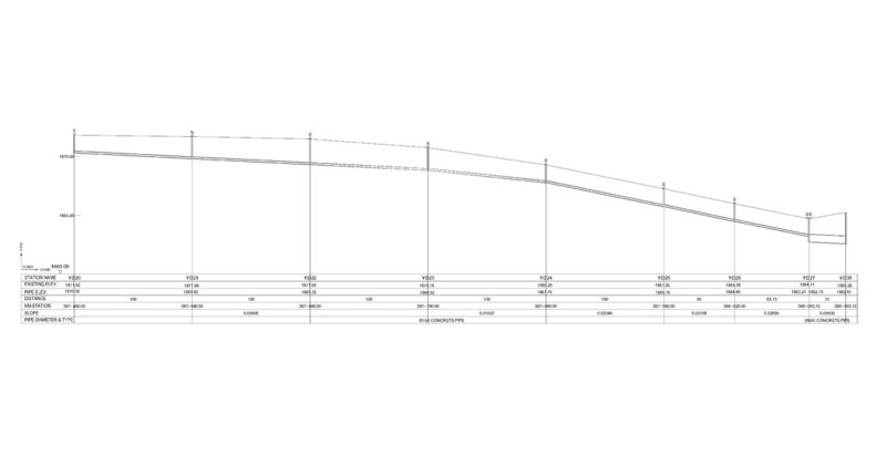

Leuthar Posted October 2, 2019 Share Posted October 2, 2019 Hello everyone, I need to create a LISP file which will be used to draw a vertical profile for the pipeline system. Vertical profile should be created using a clicked point as datum and there should be an information section right under the profile giving information about the pipeline stations, slopes between them, diameter of the pipes, etc. I'm using an excel spreadsheet to create this pipeline system and all the information needed to create the profile is written in a .dat file. I'm not familiar to LISP creation at all, I only modified a couple of files shared by my colleagues. Here is what I need help with, I have a limited time to create this LISP file, so it is better to have a similar source code which I can modify it to work as I want. Anybody who have some sort of information about this topic or have some source codes willing to share, please help me out. If you think there is an introductory information that I can examine how command lines are working it would help me a lot as well. 1 Quote Link to comment Share on other sites More sharing options...
Ish Posted October 2, 2019 Share Posted October 2, 2019 Plz upload screen shot and cad file of a vertical profile as a sample. Quote Link to comment Share on other sites More sharing options...
Leuthar Posted October 2, 2019 Author Share Posted October 2, 2019 Sample vertical profile for the pipeline is attached to this post as .dwg and .jpg file Profile-Sample.dwg Quote Link to comment Share on other sites More sharing options...
