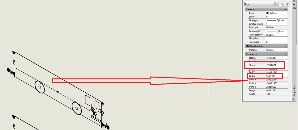

every time I use this routine it puts the lines with the values of the z axes different from 0. could not be done so that they are all on z, arcs circles polylines?
and another problem... i see all the lines are not correct as length...i suppose must scale them...0.81649..is possible by lisp?

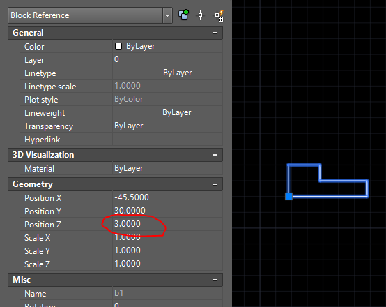

in the original listing i once had the chance to have an isometric view, every time I pressed a key I had a different view.
11 hours ago, jim78b said:
sorry don't work.
It's not clear what "don't work" means.
DId you get an error message?
I ran the program isoblock2, selected a 3D block that was parallel to the world XY plane and it rotated it to an isometric orientation, scaled it, and the move it to z = 0.  Did you want something more than this?  If so, please be specific.
isoblock2.LSP
Yes like my original lisp . It was perfect only i want that all the z values are 0 .try my lisp you see that every time you presso a key it give you a different view .your not
I modified the original program to move the shape to z = 0.  This should do what you want.  See the line:
(command "_.move" blok_ent "" "_non" '(0. 0. 0.) "_non" (list 0. 0. (* -1 (nth 2 ent_pt))))

sorry i tried it but for the block in image the z values are different from 0. sorry
Here's a 3d block at z = 3.
After isoblock3
After  a fews explodes.
I went back and experimented with the original version of isoblock you posted. For the simple shape I used here the properties indicate that the block is at z = 3  but the geometry was flattened to the z = 0 plane.  That is, although the block's reference point was not at z = 0 the geometry was.
I don't know why you are getting the result you are getting.  Was the WCS active when you gave the isoblock3 command?  Can you post the file of the block?
Tomorrow or this evenong i will post thanks
I don't use a 3d blocchi but a 2d block
I use global ucs
Edited by jim78b
