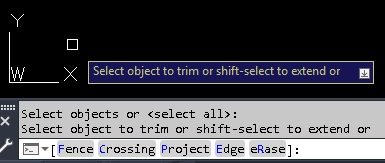

steven-g Posted October 4, 2019 Posted October 4, 2019 You should be seeing this, depending on whether you use dynamic input or just the command line, if not then can you post a screenshot of what you see on the command line. Quote

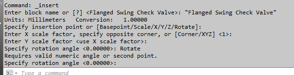

CAD_Question Posted October 4, 2019 Author Posted October 4, 2019 (edited) I run mine withing the CUI. Here is the command line. Edited October 4, 2019 by CAD_Question Quote
steven-g Posted October 4, 2019 Posted October 4, 2019 Looks like your system may well require that extra semi-colon during the insert part, try adding that back in. I created a test block and have it set to use uniform scaling which is probably why I don't need 3 semi-colons. Quote
CAD_Question Posted October 4, 2019 Author Posted October 4, 2019 That worked! Thanks for all the help on this! Quote
