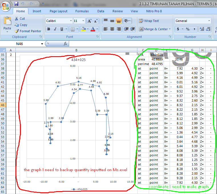

asra Posted October 6, 2019 Share Posted October 6, 2019 (edited) Hello is it possible to make lisp to extract coordinates from several polyline lines and their titles in the form of a .txt file? I have an example of the attachment below, I hope someone can help me, thank you. OUTPUT.txt MASTER CROSS SECTION.dwg Edited October 6, 2019 by asra Quote Link to comment Share on other sites More sharing options...

asra Posted October 7, 2019 Author Share Posted October 7, 2019 Thank you for your respom @BIGAL so I need this Lisp to make a graph on Ms. Exel whose purpose is to make backup quantity calculations, usually I input polyline coordinates and move the UCS points one by one. I hope there is a Lisp that can make this work faster by exporting all the coordinates in one layer to the .txt file. Quote Link to comment Share on other sites More sharing options...

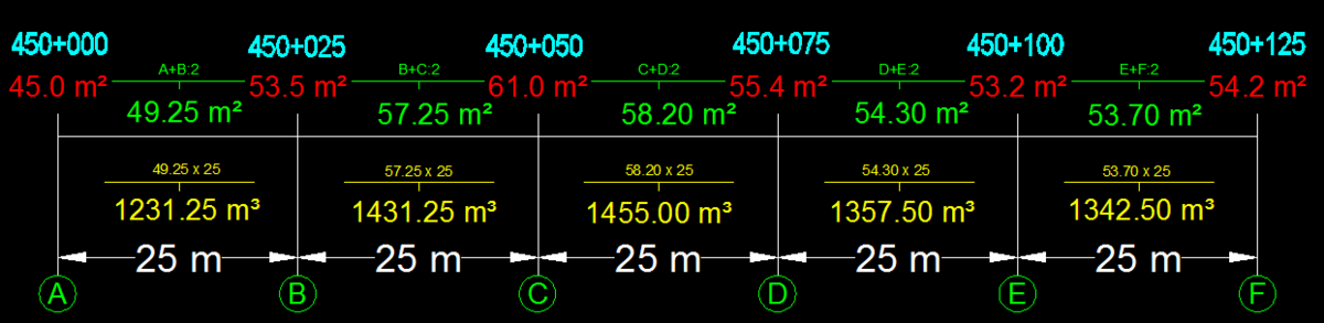

asra Posted October 8, 2019 Author Share Posted October 8, 2019 the .dwg scale that I have included in the appendix has fulfilled my needs which is 1 unit = 1 meter, unfortunately the calculation you made is not right, for more details about the calculation I include the illustration below, suppose I take an example in the cross section 450 + 000 (A) and 450 + 025 (B). - 450 + 000 (A) obtained area = 45 m2 - 450 + 025 (B) obtained area = 53.5 m2 to calculate the area between (A) and (B) we need to add and divide by 2, So the area between (A) and (B) is 49.25 m2. The final step to get the volume in m3 is to multiply the area by the distance from (A) to (B), so the volume (A) to (B) = 1231.25 m3 can be obtained. back to the beginning of the topic, in fact I only need coordinates which later to make a graph on Ms. Excel. I hope you can help me in this matter, Thanks . Quote Link to comment Share on other sites More sharing options...
steven-g Posted October 8, 2019 Share Posted October 8, 2019 (edited) Why get all complicated, what is wrong with the List command (that's not Lisp it is List), turn on logfiles =on select all the polylines 'list' open the logfile (maybe wait a m inute if there are many polylines) you can find where the log file is stored 'logfilepath'. The file will have the drawing name plus a few extra numbers with the extension .log, Change the file extension to .xls you will need to run the excel 'text to columns' on the data tab using 'space' and '=' as delimeters. Select everything turn on 'filter' you will be able to see which column to filter on and filter for the words 'text' and 'at', then select all the results copy and paste into a new sheet. It took longer to write than to do, it normally takes me just over a minute. OK timed it 2 minutes 12 seconds. A couple of points to note, select the items in order label, polyline, label, polyline,etc you need to close the drawing before you can rename the .log file you will be asked if you really want to change the extension "YES" opening the file in xls will give a warning that the file type doesn't match the extension are you sure you want to open it "YES" And lastly don't use the List command multiple times in drawing session if you make a mistake close and reopen the drawing which starts a new logfile, a logfile is created per drawing session so if you use list multiple times you will get all the results in one long logfile repeated (though that can be useful sometimes) The results are attached, you will also see I applied filters to 2 columns (the word text shows twice in the column). Edit list will also give you the area of the polylines MASTER CROSS SECTION_1c01842c3.zip Edited October 8, 2019 by steven-g Quote Link to comment Share on other sites More sharing options...
BIGAL Posted October 8, 2019 Share Posted October 8, 2019 (edited) asra I understand I am a civil engineer just retired after 40 years, your talking about using the end area method of volume calc. The hatch gives you the area write that out to excel and yes (area 1 + area 2) / 2 * distance between chainages. This is something I have done so many times. What I am talking about is a improvement to what your doing. Area is 53.471 Area is 53.161 Area is 44.982 Area is 55.407 Area is 61.021 Area is 54.205 Edited October 8, 2019 by BIGAL Quote Link to comment Share on other sites More sharing options...
