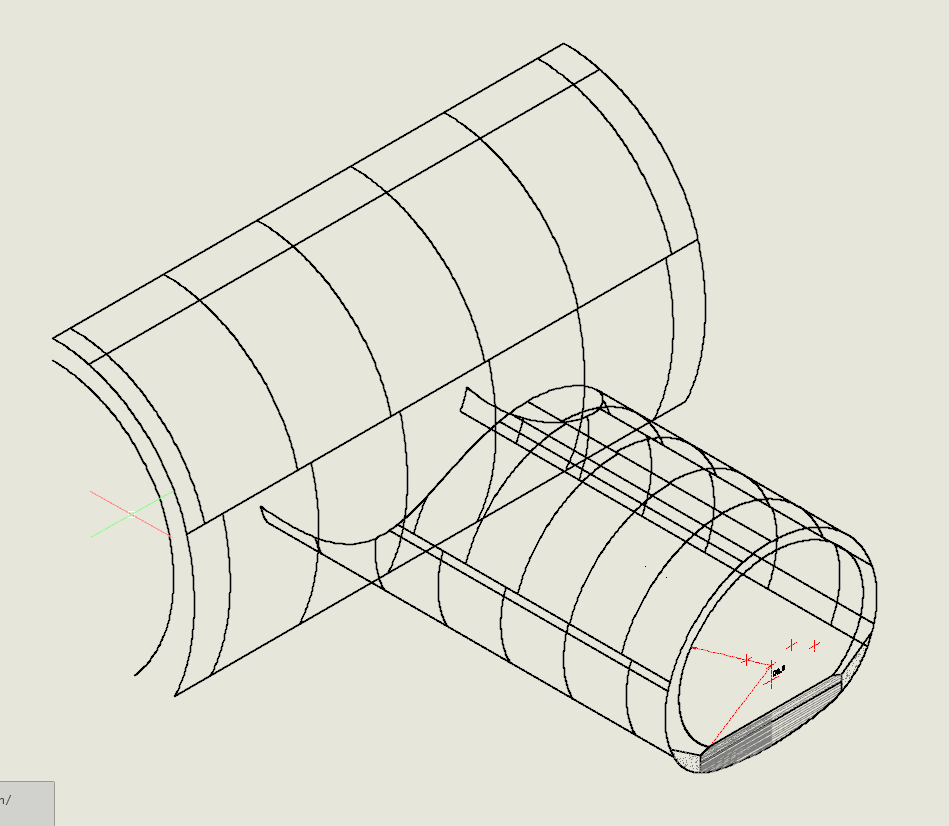

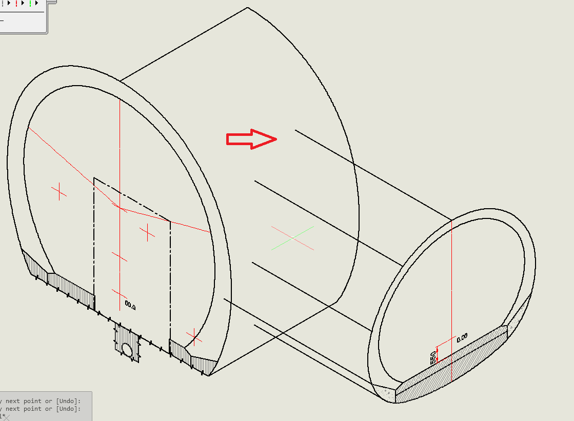

jim78b Posted October 8, 2019 Share Posted October 8, 2019 hello how can i intersect the 2 tunnels like in the figure? is difficult? i use isometric projection , snapstyl 1 I can't figure out how the 2 tunnels intersect Quote Link to comment Share on other sites More sharing options...

CyberAngel Posted October 8, 2019 Share Posted October 8, 2019 I was able to model the intersection by extruding both of the ellipses, making a copy in place of the larger one, and then subtracting it from the smaller one. The trimmed ellipse and the copy remain. 1 Quote Link to comment Share on other sites More sharing options...
jim78b Posted October 8, 2019 Author Share Posted October 8, 2019 thank you very much Cyber Angel you had inspired me! with extrude surface and surftrim i obtained what i want!!! Quote Link to comment Share on other sites More sharing options...
