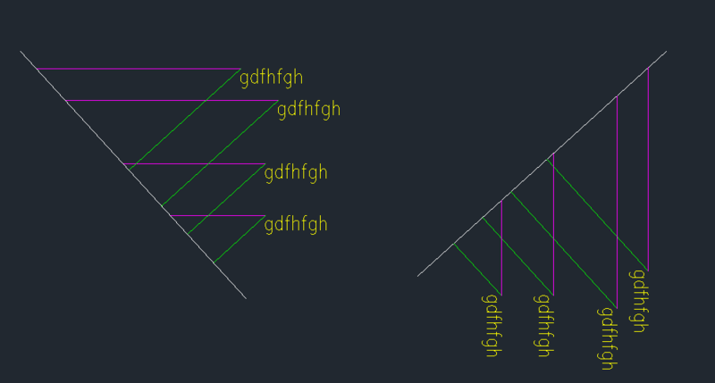

Hello Everyone !
      The posted code is working fine as per the attached image. They text are move follow with green line direction but I need move text follow with magenta line direction in selected line or Polyline.
Can anyone help me!
Code :

BIGAL
Are you happy with move based on angle of  text ? This would use a xline and intersectwith

dlanorh
As the OP wants to move to a line or pline I can see a problem arising if the xline cuts the pline more than once, when intpt will become a list min length 6 (2 points), so you would have to find the nearest intersection point.

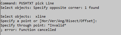

Pugazh
@dlanorh
 Yeah i'm try with line but they text are not move in line.
I got some error See the attached file .
Share this post
Link to post
dlanorh
10 hours ago, Pugazh said:
@dlanorh

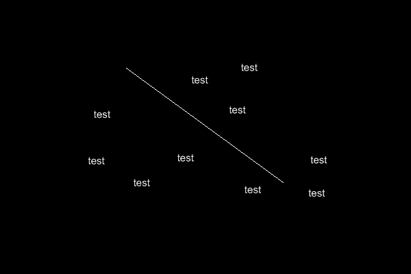

Try this
(defun rh:sammlung_n (o_lst grp / tmp n_lst)
  (setq n_lst nil)
  (cond ( (and o_lst (= (rem (length o_lst) grp) 0))
          (while o_lst
            (repeat grp (setq tmp (cons (car o_lst) tmp) o_lst (cdr o_lst)))
            (setq n_lst (cons (reverse tmp) n_lst) tmp nil)
          );end_while
  );end_cond
  (if n_lst (reverse n_lst))
);end_defun
(vl-load-com)
;; Move Text to Line along text rotation
(defun c:MT2L ( / *error* c_doc c_spc l_obj ent e_lst ss t_obj i_pt t_rot x_obj x_pts s_d x_pt)
  (defun *error* ( msg )
    (if (not (wcmatch (strcase msg) "*BREAK*,*CANCEL*,*EXIT*")) (princ (strcat "\nOops an Error occurred : " msg)))
  );end_defun *error*
  (setq c_doc (vla-get-activedocument (vlax-get-acad-object))
        c_spc (vlax-get-property c_doc (if (= 1 (getvar 'cvport)) 'paperspace 'modelspace))
  );end_setq
  (while (not l_obj)
    (setq ent (car (entsel "\nSelect Line : "))
          e_lst (entget ent)
    );end_setq
    (if (vl-position (cdr (assoc 0 e_lst)) (list "ARC" "LINE" "LWPOLYLINE" "RAY" "SPLINE" "XLINE")) (setq l_obj (vlax-ename->vla-object ent)))
  );end_while
  (setq ss (ssget '((0 . "*TEXT"))))
  (repeat (setq cnt (sslength ss))
    (setq t_obj (vlax-ename->vla-object (ssname ss (setq cnt (1- cnt))))
          i_pt (vlax-get t_obj 'insertionpoint)
          t_rot (vlax-get t_obj 'rotation)
          x_obj (vlax-invoke c_spc 'addxline i_pt (polar i_pt t_rot 1.0))
          x_pts (rh:sammlung_n (vlax-invoke x_obj 'intersectwith l_obj acextendnone) 3)
          s_d 1.0e200
    );end_setq
    (cond ( (> (length x_pts) 1) (foreach pt x_pts (if (< (distance pt i_pt) s_d) (setq x_pt pt s_d (distance pt i_pt)))))
          (t (setq x_pt (car x_pts)))
    );end_cond
    (vlax-invoke t_obj 'move i_pt x_pt)
    (vla-delete x_obj)
  );end_repeat
);end_defun
It will move the text to the nearest intersection (if more than 1) using the text angle. See attached dwg
MT2L.dwg
  • Thanks 1

BIGAL
I just tested again and working fine is the angle of the text such that a intersection point is not visually calculated ?
This will force a calculation extending lines replaced in code above
(setq intpt (vlax-invoke obj 'intersectWith obj4 acExtendboth))
Edited by BIGAL
  • Thanks 1
