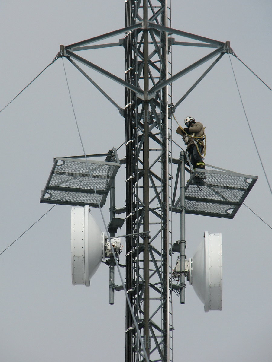

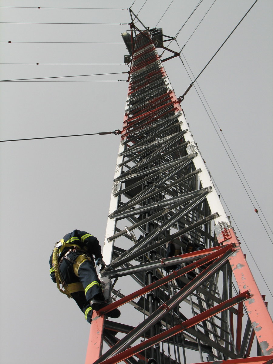

This is a sample of a guy tower with bolt tubes at each segment. These towers have existed since 1970s. I have to draw them prior to proposing any new antenna location which of course differs in pipe size at each splice as it goes up. This sample is only for solid rounds but as I mentioned on my previous posts there is also a common Angle LEG instead of all welded solid rounds or pipes.

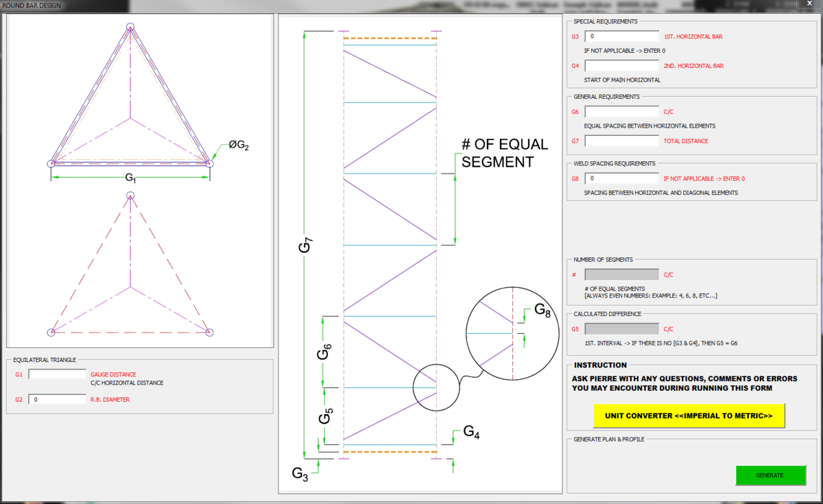

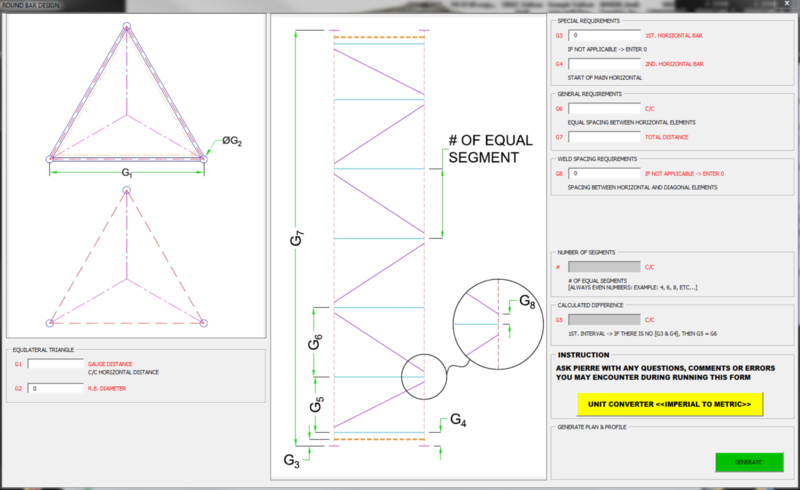

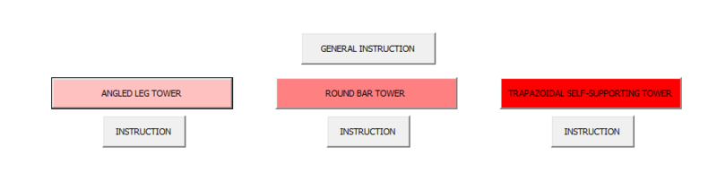

For anyone interested in tower plan and profile - I have just fine tuned my tower design. The froms are all in excel developed by myself but "rlx" has written a simple but beautiful LISP to help transfer the data from excel to cad (it was not possible without his help).
It is now up and running and can generate three style of common towers. Special thanks to BIGAL for providing feedback to better the concept.
I am hoping I am not violating the forum but for anyone interested I can send you a copy of the file. I even included instruction for the cells and also double click to convert imperial to metric and left click to paste entry - which was a pain but a nice accomplishment.
Thanks
image.png.22e6750696ae32875eb3c5f8d776089d.pngimage.thumb.png.d380fe587b480fdba9852e533757ad5d.png
The end product looks good, you can use excel to drive autocad its a two way street.
