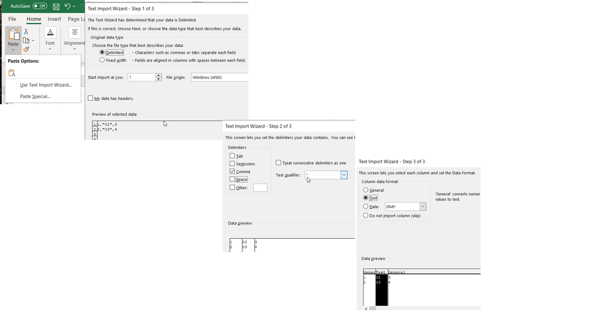

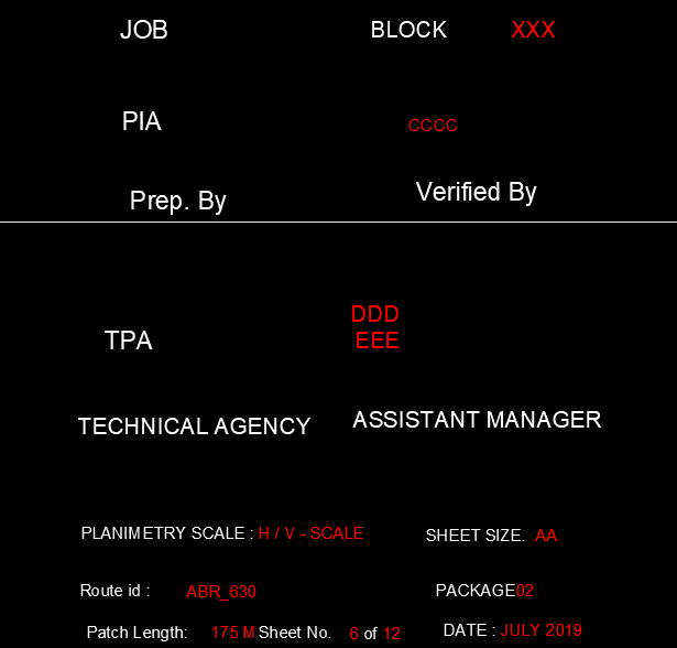

is anybody tell me how to import/export any text and paste it to it's original position in multiple layouts tab through excel as i have many layout tab in one dwg

Thanks for your valuable reply sir but i am unable to use this lsp can you please check my attached dwg may you understand what i want to say

thanks for your reply sir but sir this lisp din't export coordinates....also didn't import the same in same place that's why i ask

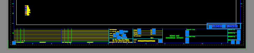

sir the problem is i have nearly 500-600 layout in my file

sir,
i only want to patch length and sheet number to export in to the excel and same import in the cad file....because our people do many mistake in patch length. please help sir this the very important step in our work
Edited by pmadhwal7

rlx
think you better take Bigal's advise and start using borders with attributes (and also learn from examples yourself)

c:t3 or just t3 is saving data , c:t4 is reading it back in a new file

Emmanuel Delay
Okay, this works.
Commands
- ETC (Export To Csv).  Then select the area of the cartouche.  Those same coordinates will also be scanned for all other layouts (except Model).
- IFC (Import From Csv).  This means it will draw new text objects to the layouts.  The layouts must pre exist !!
- UFC (Update From Csv). This means the existing text elements get updated.  So you use the same dwg (or a copy).

Now, there's Excel ... Excel tends to transform data.  Like
- every Layout name will be changed from 01, 02, 03... to 1, 2, 3.
- sometimes the decimal separators / thousands separators can be a problem (some versions have reversed . & , )
- If Entity handles get read as numbers this can mess up everything.
- Excel might not use semicolon as the default separator.
One way is to adapt the csv file with Notepad.  That's a great program that doesn't mess up your data.
(Or maybe you have found Excel settings where it doesn't mess up data, feel free to tell me about that.)
Else, look how to import a CSV into Excel.  Tab Data -> (Get External Data) From Text
-> set the semicolon separator on step 2.
-> For every column set the correct data-type.

sir, how can i change the layer of patch length in all layout??
Edited by pmadhwal7
Share this post
Link to post
BIGAL
I would have thought by now you would have started to get some idea of how to get text from the dwg using lisp so changing text property layer can be done pretty easy.
(setq ss (ssget "x" (list (cons 0 "Text")(cons 1 "Patch Length*"))))
Again the sooner you convert your info to a block the easier all these questions can be answered.
Edited by BIGAL
Share this post
Link to post
pmadhwal7
thanks sir i will try to go with your advice, please tell me where i can paste those code you given
