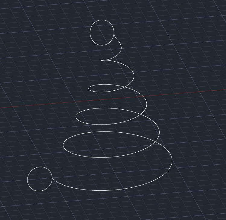

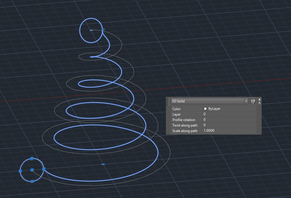

Helix, then circle, 3D rotate the circle to perpendicular then sweep, this is what i get. says 3d shape but appears as lines???
For the overall design in a perfect world i want the coils to over lap a little bit so there is no space and doesn't look like a floating spring snake but shoots back self intersecting body 🙄

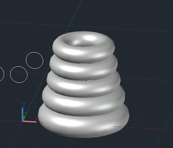

just had the idea i wonder if i could model a few stacked donuts and blend them on one side 🧐
WOW had to change the visual style in properties 🤦‍♂️

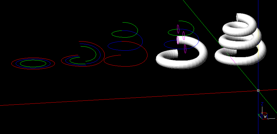

Don't know if anybody is still watching this thread but here's how you can kinda sorta do it in an older version of autocad, or in my case Bricscad.
Start out with three circles of varying diameters.  Trim them in half, and rotate one end up.  The angle will depend on the diameter of the snake and the coil. You'll just have to experiement to get it to look the way you want. Move the half circles endpoint to endpoint as shown. I color coded them so you could see which one is which.  Pop circles in at each end point as shown, and sweep them along the curves.  Depending on your cad system, you'll probably have to sweep them one at a time.  I left the head and tail up to you.

now i cant explode it....
Twistedsteel: And why would you want to explode them?
Jack: You might want to tighten up your coil as there appears to be too much of a gap, yes?

Yes, I mentioned in the explanation that some experimentation would be necessary to get it to look right. I tilted the half circles on the right up 20°.  The biggest one is a 2" radius, steps down a half inch at a time and the body of the coil is a 1" diameter circle.   A bigger circle to sweep, a less steep angle, or both. would be required.  That was a first pass, and it illustrated the idea so I just left it there.  If I get time later today I'll see about giving it another shot, and add the head and tail this time.  Stuff like that is fun to mess around with.

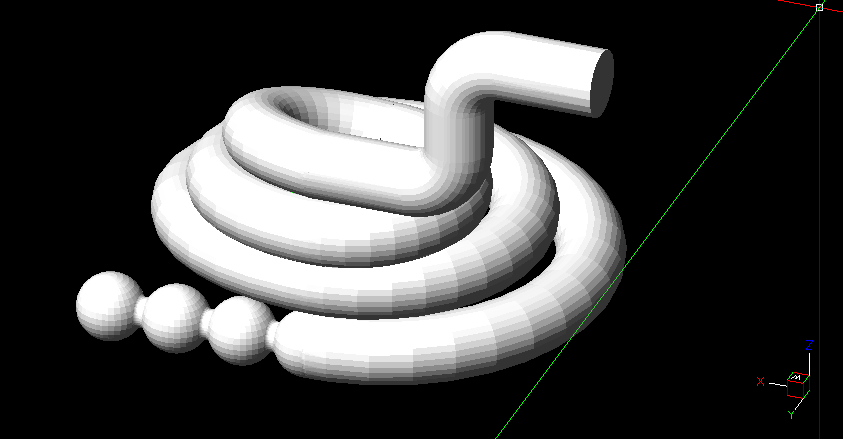

Ok,  let me be the first to say "I ain't no artist".  Cad programs of the vintage I use don't do organic shapes very well either.   The tail on this looks like golf balls impaled on a stick and I gave up on the head.   But, here is all the time i'm going to devote to this...lol

I commend your efforts, but like I always say, Autocad is not the right tool for this type of work. A poly modeling or sculpting program would be a much better choice for creating organic models like this.
