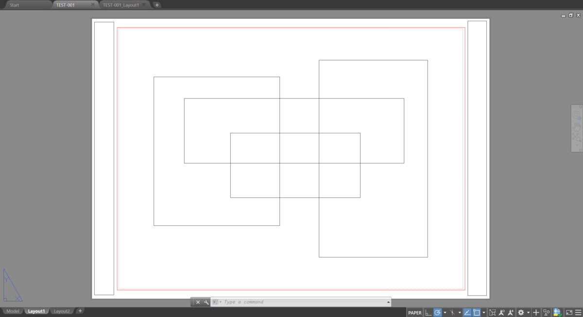

Hi BIGAL, thank you for the suggestion. I tried the CHSPACE All command, but that does not achieve what is needed unfortunately. The CHPACE command moves the Paperspace objects, such as the title sheet, to Modelspace, but the command does not 'trim' the Modelspace content to the viewports.
For clarity, I have attached a BEFORE and AFTER image of what I need to achieve, which is essentially the standard behaviour of EXPORTLAYOUT command. What I can't work out is ho to batch apply that command over multiple separate DWG files.

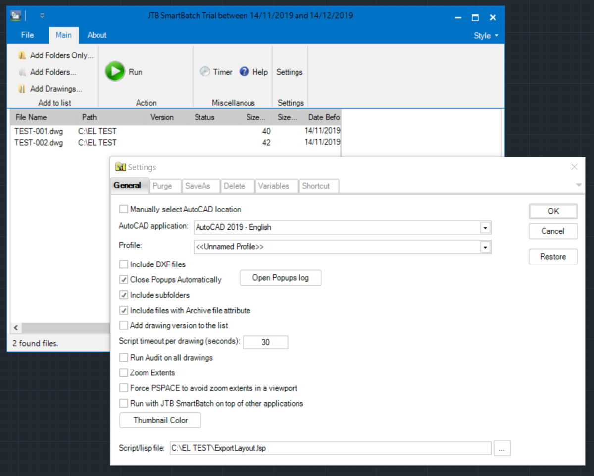

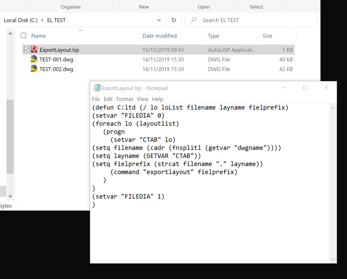

I have tried using the JTB SmartBatch tool to apply the following LSP code to my test drawings, but without success, so far.
(defun C:ltd (/ lo loList filename layname fielprefix)
(setvar "FILEDIA" 0)
(foreach lo (layoutlist)
     (setvar "CTAB" lo)
(setq filename (cadr (fnsplitl (getvar "dwgname"))))
(setq layname (GETVAR "CTAB"))
(setq fielprefix (strcat filename "." layname))
     (command "exportlayout" fielprefix)
(setvar "FILEDIA" 1)

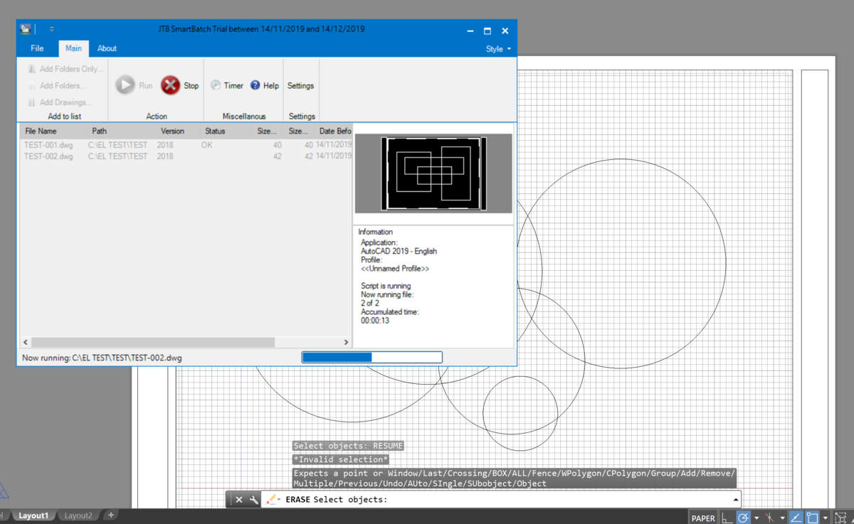

When running the SmartBatch tool, the drawing stops and requests ‘ERASE Select objects’, as per attached screenshot. Also, on all occasions of running the batch, no new drawings were created. Essentially, the EXPORTLAYOUT didn’t appear to run.
Any suggestions what I'm doing wrong?

It may be this line needs a location to save the dwg as well. Tried without then with and was ok.
(setq fielprefix (strcat (getvar 'dgwprefix)  filename "-" layname))
