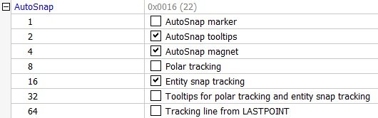

The system variable that you require for this task is AUTOSNAP.
This system variable is bit-coded, with the following bit codes exhibiting the associated behaviour as described below:
  • 0    Turns off the AutoSnap marker, tooltips, and magnet. Also turns off polar tracking, object snap tracking, and tooltips for polar tracking, object snap tracking, and Ortho mode
  • 1    Turns on the AutoSnap marker
  • 2    Turns on the AutoSnap tooltips
  • 4    Turns on the AutoSnap magnet
  • 8    Turns on polar tracking
  • 16    Turns on object snap tracking
  • 32    Turns on tooltips for polar tracking, object snap tracking, and Ortho mode
As such, to control Polar tracking, you'll need to flip bit 8.

Checked in Autocad was 39 Briscad 119 so quick and dirty write down the numbers required after running lee's code.
(setvar 'autosnap 47)
(setvar 'autosnap 39)
Edited by BIGAL
4 hours ago, BIGAL said:
Checked in Autocad was 39 Briscad 119 so quick and dirty write down the numbers required after running lee's code. 119 is odd ?
Does not work in Briscad
Sorry, I've re-read this several times over, but I still don't know what you are trying to say here?
Sorry Lee. changed post for clarity, thanks Steven-g
When I tried the above code in Briscad the other day it did not work, today it did including 64 check it showed no 8 to be set. Just one of those things, why did it not work the other day ? Not something I would use so did not look further into it.
