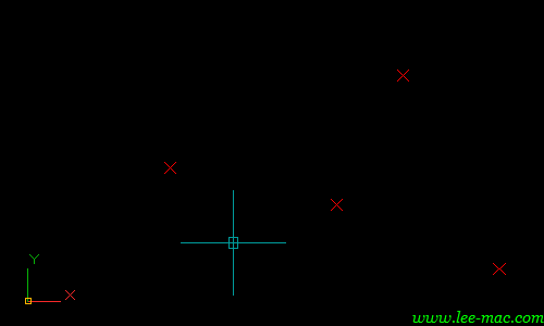

So the problem im having is i have code that runs to show the offset of measured points to design points, unfortunately the code works by inserting one of 4 predefined blocks for NSEW, or one of 4 when in 2 directions; only showing orthogonal distances. These work by passing through the distance to the block tag, and then comparing the EW, and/or NS values to determine the correct arrow direction to insert the correct block.
What i want is instead of using orthogonal distances, is to have an arrow block within these blocks, that changes the direction of the arrow, based on a bearing that you pass through.
eg if the horizontal distance between 2 points is 25mm at a bearing of 45 degrees, then a tag is created as per normal with 25 and an arrow point 45 degrees.
Any good ideas? I've looked in the forums and couldn't find anything to solve this. Attached is an image of what i have currently made, note the aligned one showing 130mm is kinda what i want, but that arrow is not dynamic, it just goes left or right and the whole block is just rotated to show the bearing. It makes for a messy plan and a lot of neck craning to present to a client
Assuming that I've correctly understood what you are looking to achieve, you could define a basic dynamic attributed block containing a single attribute to display the distance, and a rotation parameter with a rotate action assigned to the arrow symbol within the block. Then, you can use a program to automatically insert the block, populate the attribute, and configure the dynamic block parameter appropriately:
To offer an example to demonstrate this in action, try using the following code in conjunction with the attached dynamic block:

The above uses existing functions from my Attribute Function library and Dynamic Block Function library.
test.dwg
Hey the Lee Mac! I've used some of your codes and tutorials from your website.
Really appreciate you taking the time to write all this, this is exactly what i was looking for.
It looks like i have a lot to learn about working with dynamic blocks, and this has been an incredibly helpful starting point.
I also am not at all familiar with the use of VLA functions, so l was really intrigued by your use in property definition and block insertion. In searching for more info i actually found a helpful post from 2008 😉
Thanks again, this has been a good example of what i can be doing with Lisp
