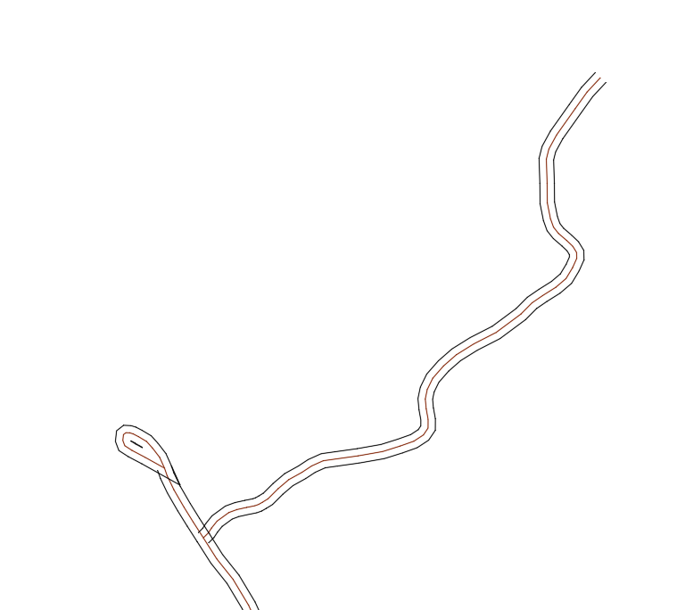

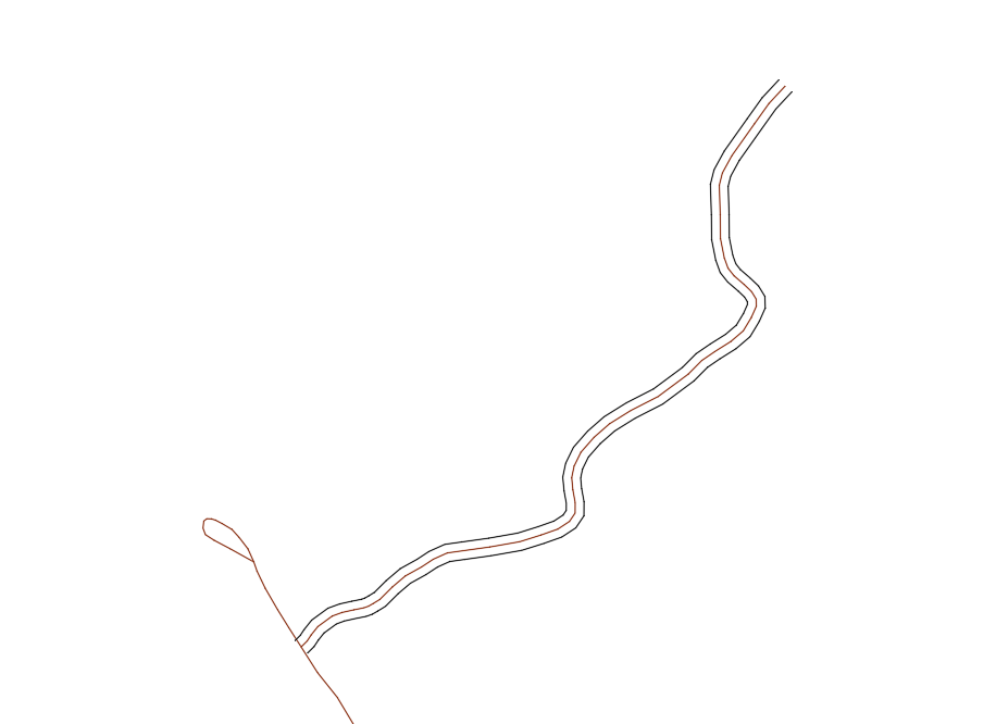

Currently using Lee Mac's doff-lsp (Double Offset) and I find it useful.
I wonder if it is possible to rescript so we select multiple objects instead of needing to click on every separate polyline.
See example below:
In order to double offset all three polylines below I would need to doff tre separate objects.
Is it possible to get below result by rescripting the code to select multiple objects?
My original Double Offset application was designed to precisely emulate the prompts & options offered by the standard AutoCAD OFFSET command, however with the offset being performed to both sides rather than a selected side.
Here's a quickly written alternative to permit multiple object selection:
