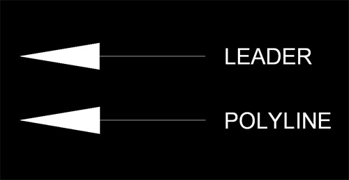

Cad64 Posted January 30, 2009 Share Posted January 30, 2009 You could create a leader with a Polyline. Then you could adjust the landing to whatever length you need. For example: Command: PLINE Specify start point: (Select starting point on screen) Current line-width is 0.0000 Specify next point or [Arc/Halfwidth/Length/Undo/Width]: W Specify starting width : 0 Specify ending width : .340 Specify next point or [Arc/Halfwidth/Length/Undo/Width]: (Select point on screen) Specify next point or [Arc/Close/Halfwidth/Length/Undo/Width]: W Specify starting width : 0 Specify ending width : 0 Specify next point or [Arc/Close/Halfwidth/Length/Undo/Width]: (Select point on screen) Quote Link to comment Share on other sites More sharing options...
peterhuang913 Posted January 30, 2009 Author Share Posted January 30, 2009 Ok, that works, but I'm working with a right angle arrowhead. I suppose I can just draw it out, to imitate it, but it defeats the purpose of having an arrowhead feature. I'm using mleader to make a ray on each side of a text. Kinda like, So there's no really way around the size limitation of arrowheads? Quote Link to comment Share on other sites More sharing options...
