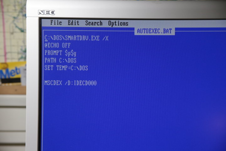

here it is. The only way I could figure to access it was to type at the C prompt,  "EDIT AUTOEXEC.BAT"

I don't see where a mouse driver is being loaded.  For example...
LH C:\MOUSE\MOUSE.EXE
Or...
LH C:\MOUSE\MOUSE.COM

Thank you!
I got it working.
