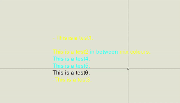

Could someone let me know how to use put-string to arrange text by colour so that example: all content in colour #2 remain but contents in colour # 0 and #4 are removed without changing any of the text format or style?
I looked up Wmatch but it seems I cannot get anywhere with that.
(setq txt(vla-get-TextString(vlax-ename->vla-object (car (entsel)))))
(vla-put-textstring obj ...)
not quite sure how to deal with :  "\\pxse1.01;{\\C2;TEXT1\\PTEST2\\PTEST3}\\P{\\C4;TEST4\\PTEST5\\PTEST6}" to separate specific colours and merge them.
I am also thinking if I could ask which colour to remain, then any other colour could just be removed - this way not complication would arise from conditioning the colour numbers.
it could simply be Colour #0 + any colour stored on "Colnum" variable to stay.
(setq Colnum (getint "\nWhich Colour to Stay"))
Any ideas?

(vl-string-search "\\C4" txt) =53
(vl-string-search "\\C2" txt) = 11
So needs loops that removes "{\\Cx;" from string. Until not found. A (strcat subst + subst) maybe a lambda function something I am not good at.
Oh must find ending } also and remove. (vl-string-search pattern str [start-pos])So use start-pos as say 53+4
(vl-string-search "}" txt 57) = 84

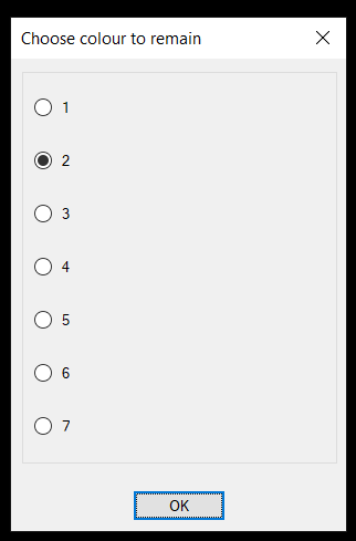

If using say 1st 7 colours something like this.
@BIGAL
I am not familiar with VLAX that much. The scramble does work though for me - Thank you AGAIN for your help.
Now the next step would be to bring in your radio button DCL and make it pretty. Also not quite sure to say remove (4) Cyan context while change (2) yellow to (0) white.
Could you please show me how?

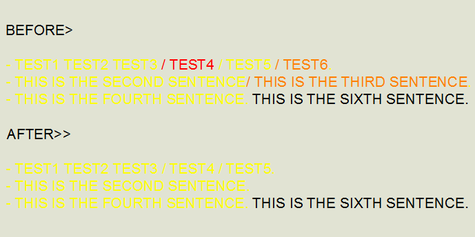

What I would like, as the gif posted above partly explains is 1) to remove certain content with specific colours entirely and 2) change certain content colours to another colour - all this without revising any of the text style or formatting.
As can be seen above, if I have the flexibility of hardcoding my intended colours instead of remembering the colour number I would have a better chance of not messing up and also use corresponding "Multi Radio But" afterward.
This is just an example but all yellow (#51) remains as well as any BYLAYER (black). The content of colour red (#1) is then changed to yellow (#51) and Orange (#30) is then removed.
Again, I was able to substitute but had to luck in removing content of a certain colour.

Here's my new version. This gives you a choice to Change the Color, Strip the Color, or remove the text in that color completely. Give it a try:
(defun c:test (/ doc idx opt St1 strcol Con1 ncol Txt1)
   (vla-startundomark (setq doc (vla-get-activedocument (vlax-get-acad-object))))
   (if (not g:def)(setq g:def "Strip"))
	(if (and
		    (setq Str1 (car (entsel "\nPick mtext: ")))
          (setq strcol (getstring "\nEnter ACI color number to remove: "))
             (initget "Change Strip Remove")
             (if (not (setq opt (getkword (strcat "\nSelect Text Option [Change color/Strip color/Remove text]: <" g:def ">"))))
                (setq opt g:def)
                (setq g:def opt)
		    (= "MTEXT" (cdr (assoc 0 (entget Str1))))
		    (setq Con1 (vlax-ename->vla-object Str1))
       ) ;end and
		    (setq Txt1 (vla-get-textstring Con1) strcol (strcat "\\C" strcol ";"))
      	 (while (setq idx (vl-string-search strcol Txt1))
             (cond
                ((= opt "Change"); Change to a different color
                    (if (or ncol (setq ncol (getstring "\nEnter new ACI color: ")))
                       (setq txt1 (vl-string-subst (strcat "\\C" ncol ";") strcol Txt1))
                ((= opt "Strip"); Strips the color codes for the text where found.
                   (setq txt1
                      (strcat
                         (substr txt1 1 idx)
                         (substr txt1 (+ 2 (vl-string-search ";" txt1 idx)))
                ((= opt "Remove"); Remove anything in the string up to the next closing brace "}"
                   (setq txt1
                      (strcat
                         (vl-string-right-trim "{" (substr txt1 1 idx))
                         (vl-string-left-trim  "}" (substr txt1 (1+ (vl-string-search "}" txt1 idx))))
          (vla-put-textstring Con1 Txt1)
    	 ) ;end progn
  	) ;end if
   (vla-endundomark doc)
) ;end defun
EDIT - Had to make a small correction for the "Change" option.
EDIT 2 - Updated "Strip" option so any other Formatting is left intact.
Edited by pkenewell
      	    ) ;end and
	(setq Txt1 (vla-get-textstring Con1))
	;CHANGE (#150) TO (#BYLAYER)
      	(while (vl-string-search "\\C150;" Txt1) (setq Txt1 (vl-string-subst "" "\\C150;" Txt1)))
	;CHANGE (#7) TO (#BYLAYER)
      	(while (vl-string-search "\\C7;" Txt1) (setq Txt1 (vl-string-subst "" "\\C7;" Txt1)))
	;CHANGE (#0) TO (#BYLAYER)
      	(while (vl-string-search "\\C0;" Txt1) (setq Txt1 (vl-string-subst "" "\\C0;" Txt1)))
	    (while (vl-string-search "\\C2;" Txt1) (setq Txt1 (vl-string-subst "\\C1;" "\\C2;" Txt1)))
  	;REMOVE COLOUR (#30)
	(while (setq idx (vl-string-search "\\C30;" Txt1))
	(setq Txt1 (strcat (vl-string-right-trim "{" (substr Txt1 1 idx))
	(vl-string-left-trim  "}" (substr Txt1 (1+ (vl-string-search "}" Txt1 idx)))))))
  	;REMOVE COLOUR (#51)
	(while (setq idx (vl-string-search "\\C51;" Txt1))
  	;REMOVE COLOUR (#22)
	(while (setq idx (vl-string-search "\\C22;" Txt1))
  	;REMOVE COLOUR (#82)
	(while (setq idx (vl-string-search "\\C82;" Txt1))
  	;REMOVE CHARACTER (/)
	(while (setq idx (vl-string-search "/" Txt1))
	;SUBSTITUTE (DOUBLE SPACE) WITH (SINGLE SPACE)
      	(while (vl-string-search "  " Txt1) (setq Txt1 (vl-string-subst " " "  " Txt1)))
  	;(while (vl-string-search "BLAH" Txt1) (setq Txt1 (vl-string-subst "TEST" "BLAH" Txt1))) ; WORD SUB
) ;end progn
  	) ;end if
) ;end defun
Could you please let me know why I am having this error with some Mtext - perhaps the number of characters or arguments exceeds the limit - is there such thing or is there an issue in my routine? The TEXT SAMPLE.dwg attached works but anything with longer content seems to come up with an error!
TEXT SAMPLE.dwg
Edited by Sambuddy
