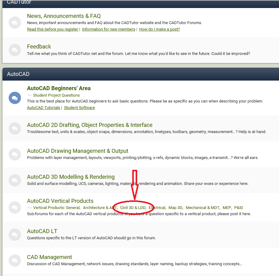

SLW210 Posted January 10, 2020 Share Posted January 10, 2020 Why aren't you posting your Civil 3D questions in the Civil 3D & LDD Forum? Quote Link to comment Share on other sites More sharing options...
Silvercloak Posted January 10, 2020 Author Share Posted January 10, 2020 I couldn't find it. I looked at the main forum page and didn't see it there at all. Quote Link to comment Share on other sites More sharing options...
SLW210 Posted January 13, 2020 Share Posted January 13, 2020 Quote Link to comment Share on other sites More sharing options...
SLW210 Posted January 13, 2020 Share Posted January 13, 2020 No problems, if you don't see a specific forum, just ask and someone will point you in the right direction. Quote Link to comment Share on other sites More sharing options...
