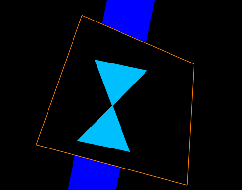

    One problem I've having is getting my fittings to appear when the drawing is plotted.  I can't get convertlineworktomaskblock to mask any plan view pipes.  Nor does wipeout seem to help me.  I've created a Valve style and tried to use part mask to mask the pipe out.  Right now I'm getting this;

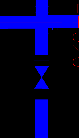

When what I actually want is more like this;
I really do NOT want to go back to just using polylines and blocks.  Please tell me there's a solution to this.
Silvercloak
Draw order can be quite critical when using wipeout I had underlying, then mask, then new over top in mask area. From memory do backwards draworder top 1st.
That's the first thing I tried.  It hasn't made a difference.  I'm absolutely baffled as to why this isn't working.  I know it CAN work because I had Null structures that were breaking the pipe previously that I used to turn off when I didn't need to see them.  Now even they aren't breaking the pipe with part mask.  I'm completely baffled as to what changed to make this pipe seemingly indestructible. :P

Worked for me just did draworder. kept wipeout outline so can see. Make sure your wipe out is on a plot on layer.
Edited by BIGAL
Is that structure masking or just a wipeout separate from the structure?
Separate wipeout, the valve is a Aecc object I haven't used so if a block maybe check wipeout draw order.
I bedited PWBEGV and added a wipeout, then draw order to back, save new block, seems to have worked.
