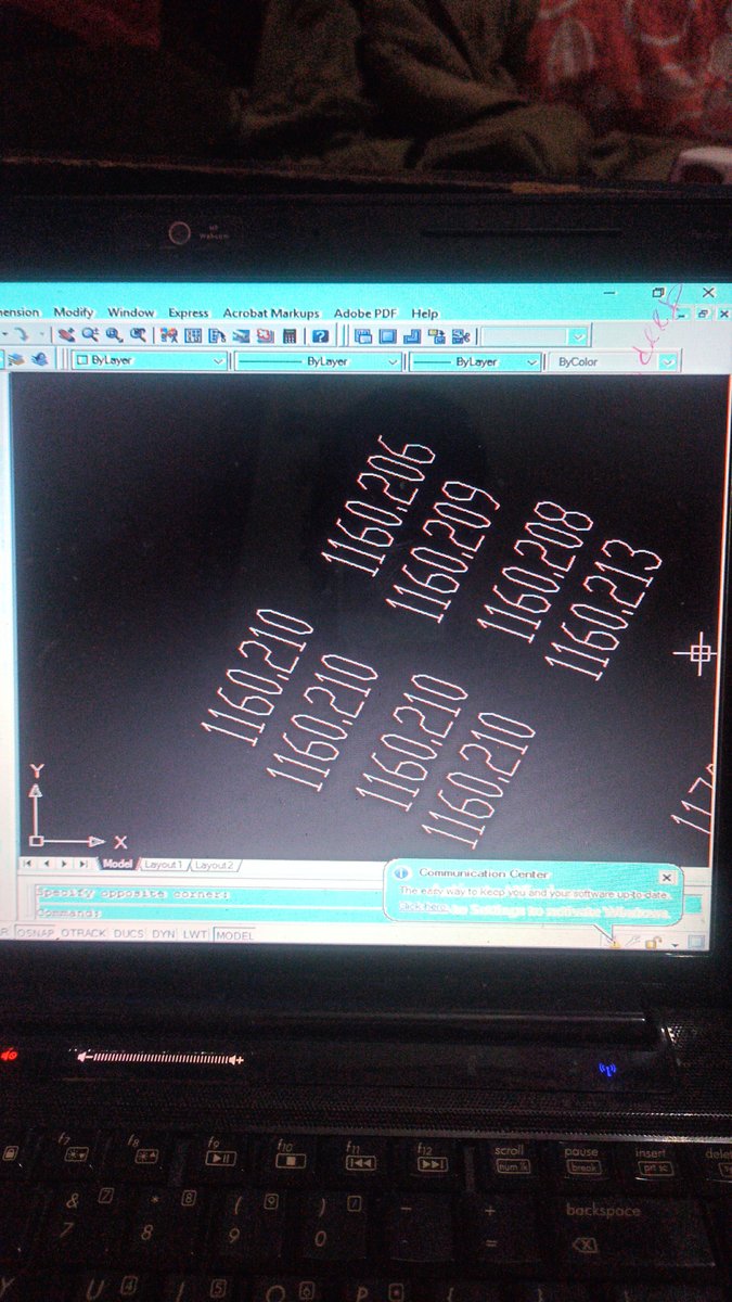

pmadhwal7
46 minutes ago, Lee Mac said:
Yes sirrr very useful... thanks i will try it once and will try again... thanks but it was removed my 2nd digit and place new digit check the screenshot
Quote

Lee Mac
34 minutes ago, pmadhwal7 said:
Yes, the program performs exactly as @eldon has described - the resulting values will always round to the original when rounded to 2 decimal places.
If you strictly require the second digit to remain unchanged, and also avoid the value being rounded up to the next hundreth, you could change this line:
(entmod (subst (cons 1 (rtos (+ (atof (cdr v)) (* (LM:rand) 0.009) -0.005) 2 3)) v x))
To:
(entmod (subst (cons 1 (rtos (+ (atof (cdr v)) (* (LM:rand) 0.0045)) 2 3)) v x))

pmadhwal7
To:
Thanks a lot this is working fine i will try it to main file.....

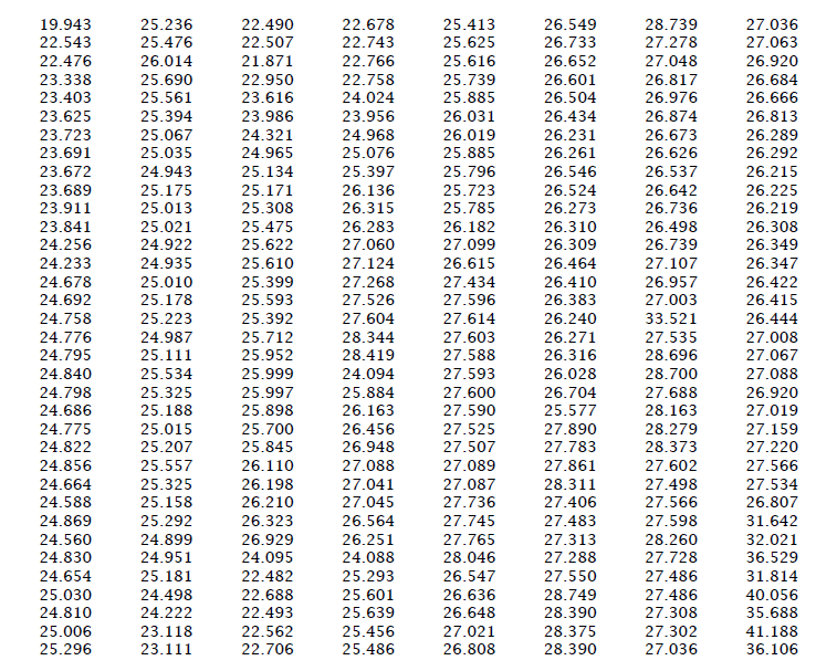

eldon
1 hour ago, Lee Mac said:
This seems like a really daft thing to do, but -
If the original survey data (I am assuming this to be a topographical survey drawing) were to be available, then this whole furore would be unnecessary. But if that is not the case, then the least damage that is done to the existing data is good.

eldon
Here is a list of elevations from the latest survey I am processing. It shows the random nature of the third decimal place.
