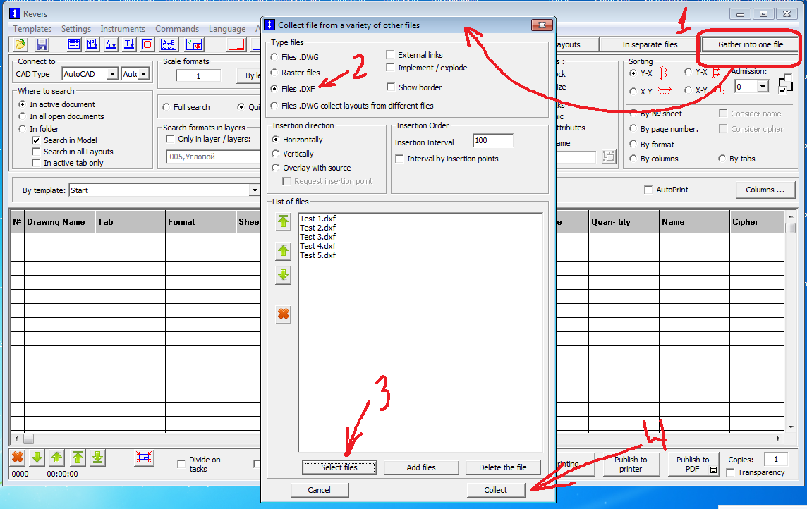

On 2/14/2020 at 4:12 PM, maratovich said:
Maybe this will help you:
What is this? :D
