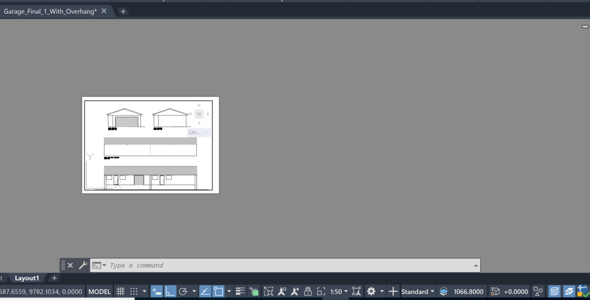

efg Posted January 29, 2020 Share Posted January 29, 2020 Hi, I have a drawing for a garage that I have created in the model space and the units are set to mm whilst the page setup is set to A2. I have double checked the dimensions on the model and they are correct and now need to export to PDF. Can someone please let me know how I can export to PDF at a scale of 1:50 @ A2. I have exported to PDF using the page setup as A2 and then printed on A4 but need to confirm that the scale is correct before sending it to the printers to print at A2. Thanks Quote Link to comment Share on other sites More sharing options...

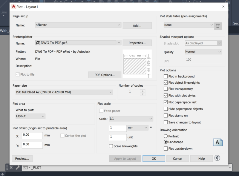

efg Posted January 30, 2020 Author Share Posted January 30, 2020 Thanks for the help. I need to export to PDF to send it to the planning department but the export has to be accurate as they will print from the PDF. This is what I have at the moment, the scale is set to 1:50. The printer settings are also shown below. Are these correct? Quote Link to comment Share on other sites More sharing options...
BIGAL Posted February 1, 2020 Share Posted February 1, 2020 Should work ok, We have a title block A1 size but always plot A3 unless asked for a contract set of A1's, so A3 a scale of 1:2 it is dimensionally correct, but the old adage never scale of a paper sheet. Refer to my post above I would use "window" and "Center the plot" a bit more reliable than "layout". 8 designers always worked. Quote Link to comment Share on other sites More sharing options...
efg Posted February 1, 2020 Author Share Posted February 1, 2020 Many Thanks BIGAL, followed your instructions and the export has worked. Quote Link to comment Share on other sites More sharing options...
