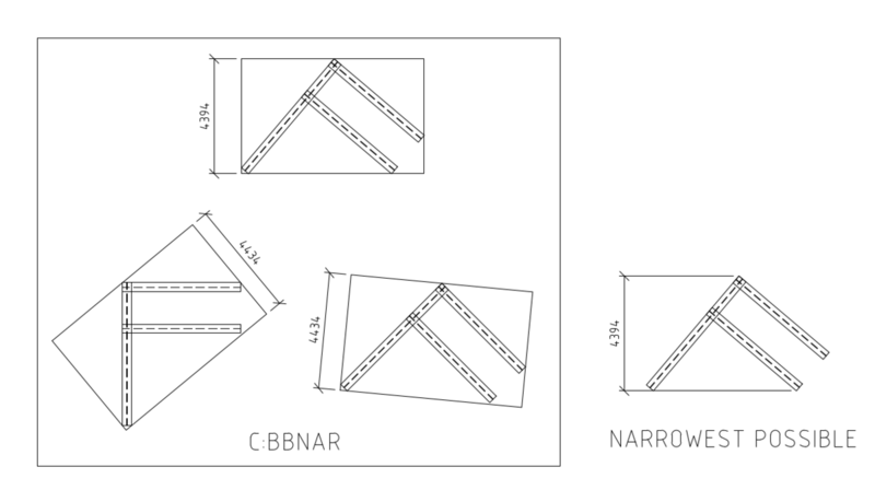

Another 'boundary generate' question - possibly with a bit of a twist.
I am looking for a routine that will generate a boundary that has the minimum possible width of the selected objects.  Please see sketch below and attached DWG for example.
I am not trying to generate the smallest possible boundary (like Lee's routine here), rather I am trying to create the narrowest possible boundary.  For example, to work out if a load is too wide to fit on a truck trailer.
Anyone know of a LISP routine that will perform this?
Thanks for any help

You could use the same method as used by my program, but instead of using the bounding box area to as the comparison metric, use the minimum of the length of two adjacent sides. For example, in my code, change these lines:
bx1 (* (- (caadr box) (caar box)) (- (cadadr box) (cadar box)))
bx2 (* (- (caadr box) (caar box)) (- (cadadr box) (cadar box)))
To:
bx1 (min (- (caadr box) (caar box)) (- (cadadr box) (cadar box)))
bx2 (min (- (caadr box) (caar box)) (- (cadadr box) (cadar box)))

Thanks for the replies guys.
@Lee - I have made the changes to your code, done a bit of testing an have found that sometimes it will generate the narrowest possible boundary, and sometimes not.
It appears to be affected by the rotation/orientation of the elements.  Please see attached DWG and sketch below for example.
Any suggestions to optimise the boundary generation any further?
Thanks again for your help 👍
Bear in mind that the method implemented by my Minimum Bounding Box function is an iterative approximation: the set of objects are incrementally rotated by an angle determined by the supplied precision parameter (in your case 0.01); reducing the magnitude of the precision parameter will cause the result to tend toward the true minimum bounding box - though of course, at the sacrifice of performance.
As such, if you require a more accuracy in the bounding box, try increasing the precision by an order of magnitude, e.g.:
(LM:narboundingbox sel 0.001)
Awesome, thanks so much for the reply Lee.
I've reduced the rotation precision parameter and the results are sooooo close to spot on.  As you suggest, I could go further and keep reducing the rotation precision, but the performance trade-off may not always be worth it (if the difference is only a few mm).
Definitely a great result for the intended application.
Thanks again Lee and everyone for your help.
