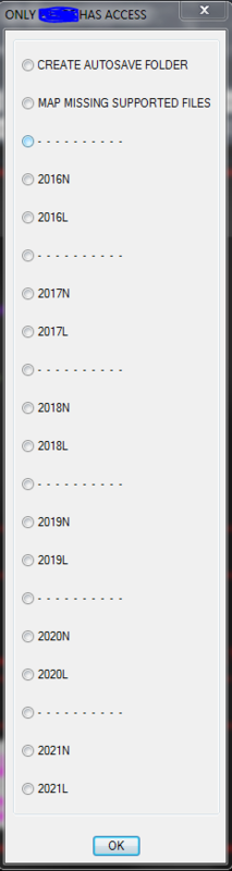

And now Thanks to BIGAL's DCL, I have a very easy setup:
@BIGAL is it possible for this to be in two or more rows, if yes, how SIR?
my next challenge is now to create a lisp for publishing > windows to select sheets > a button to select all sheets > select pen assignment > PDF or Printer > select page setup name
any ideas would be appreciated.
I have thought about 2 rows or columns, it becomes a bit more complicated but not impossible. Grrr or Rlx have written some multi box dcl's that may be a better way to go it would arrange in a grid pattern. Hopefully they will respond.
