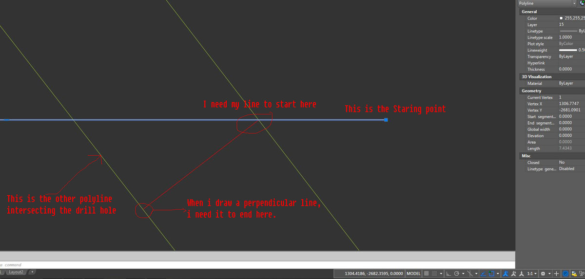

I need to make a routine for myself and my co workers.. ok heres the situation
i will be given loads of plan maps from GEMS.And what we need to do is to find the starting point of a polyline
and from there, create a perpendicular line across the next polyline..
its something like this:
I have attached one sample:
the lines i need is on the layer "perps"
is this even possible? They will be dumping us DWG files like this starting tomorrow.
and im talking hundreds of files to be manually look for the starting point to determine where the line starts.

You want that line in layer "perps" and color red, yes?
Command PFP.
In a while loop, you select the start point (intersect of the polyline with the white line), then select the other polyline (where the perpendicular line ends)
Repeat.

If those green polylines were 1 polyline * on the left, and 1 on the right, this routine could be further automated.
Then you would just select polyline 1 (where the red line starts), select polyline 2, then window select the white lines.
the routine finds the intersect points, and automatically draws all the red lines at once.
(* this can be done with polyline edit -> join)
Is this something you might want as well?

yes sir! this is the one! i love it! i will use this!
if it will automate further i will just join all the yellow polylines
