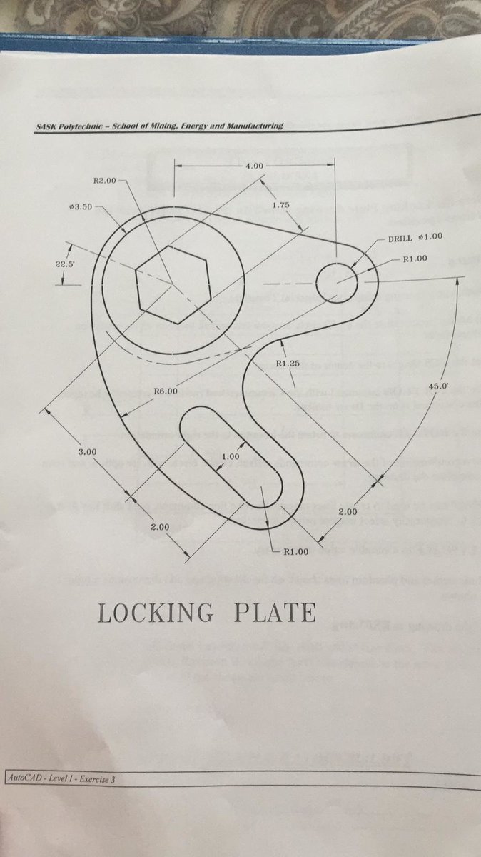

kamran Posted March 3, 2020 Share Posted March 3, 2020 I have got this small drawing to made, I am stuck in between and couldn't understand how to complete. Can anyone help or if someone can quickly draw, I can then study how its done. Ex03.dwg Quote Link to comment Share on other sites More sharing options...
ReMark Posted March 3, 2020 Share Posted March 3, 2020 (edited) Are you familiar with the command SNAPANG? It can be used to turn your crosshairs to any angle you need. In this case you want to set it to 45. You can then draw the two construction lines that extend from the center of the polygon. Once you have these lines drawn they can be offset to establish the intersection points needed to construct the lower part of the locking plate. Note: This exercise will benefit from the use of the Circle command with the TTR option to create the arcs with the radii of 1.25 and 6.00. TTR stands for Tangent-Tangent-Radius. Edited March 3, 2020 by ReMark Quote Link to comment Share on other sites More sharing options...

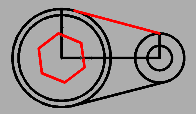

eldon Posted March 3, 2020 Share Posted March 3, 2020 My comments would seem to be a bit late, but I will mention it anyway. There appear to be a couple of anomalies in the drawing supplied. The top line is not tangential. The hexagon is not at the correct angle. Hope your friend spotted these before the drawing was sent!! Quote Link to comment Share on other sites More sharing options...
